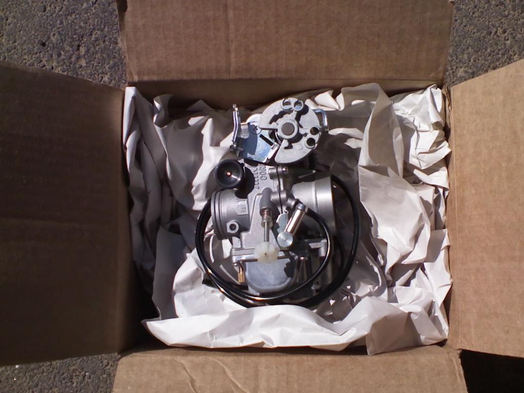

I pulled the trigger and bought myself a late birthday gift and it arrived today, a nice shiny pumper carb. I got it bolted up in a jiffy but found I needed a few minor adjustments.
1 The main jet's cap is hitting the starter (need to turn the nut)
2 Bogs when you whack the throttle (moved clip to 3 adj, pump timing)
3 Seems to want a bigger pilot jet
4 Throttle is sticking a bit
5 Neighbor said it sounded louder so he came over promptly!
After messing with the cool new ***** and screws it smoothed out a bit and I"ll have to re-route the throttle cable under the wiring but I do like the new "Power Now" option. So far it seems smoother than the stocker I hated the lag and the erratic off throttle response. Could have been a jetting mistake on my part but I liked it on the rich side.
If anyone's got a link to a good tuning manual I would appreciate it. The little graph on a card they sent me is a bit to barbaric to make any sense. If you want to throw out a good baseline jetting I would love to hear your opinion. My ele. is 600ft and the rest is in my sig. I did get a few jets with my order 10, 15, 125, 135 and I adjusted the squirter to hit the needle although it misses a bit if you gently tap the throttle from closed.

"2 Bogs when you whack the throttle (moved clip to 3 adj, pump timing) "
How did you adjust the AP timing?
[edit]
Sorry I can't read. I incorrectly assumed you got yourself one of those TM33/34 carbs. Those do not have adjustment for AP.
But after looking at the picture of your carb I realized you must have the 36.... which you said in the Subject line but I missed it.

You got a pic of it in the box.... but not on the bike?
what a teeze....
