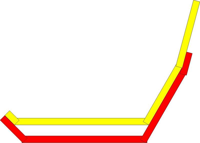

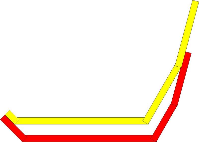

Mike,
I was looking over MavAus's CRD plate pics again this morning, and I noticed something that might help on the issue of the contact with the weld on the bottom of the frame. I don't pretend to know much about this, but I figure you can take it or leave it.
It looks to me that the bottom portion of the CRD plate does not contact the frame at all (except for the mount points of course). It looks like the plate extends at an angle from the back mount point and goes below the bottom of the frame before making the bend that takes it parallel to the ground. It then extends forward and bends again to start to follow the angle of the bike. I can't quite tell if it follows the bike directly up or if it leaves a similar gap in the forward section.
If this were done with just a little gap below the bottom of the frame, I would think you could avoid the weld and also minimize contact points that might result in rattling. One question I have is how to handle the middle mount point. The more I think about it, I would think that the point where the plate needs to angle up could follow the line of the bike more closely and contact the bike at the bottom and top of the front angled portion.
Here is an extremely crude sketch of what I think might be going on.
Sketch with front portion contacting frame
Sketch with gap between front portion of plate and frame
Anyway, like I said, take it or leave it. Just a thought.
Thanks,
Chris
Thanks,
Chris
