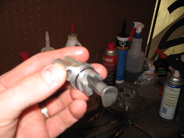

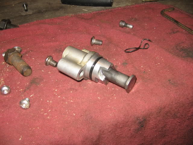

That video was the cam chain noise, i already had the rattle noise taken care of it was the balancer gear that was rattling on my bike, a C clip came out... if there is a rattle between 4500-5500 thats the problem.
then this happened to the tensioner...

Where did the piece go? Did you find it, or did it make itself known in a bad way? Hope all is okay.
