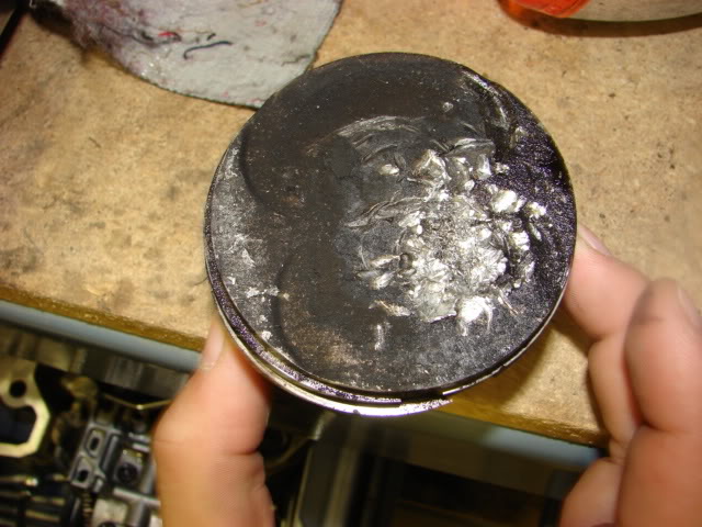

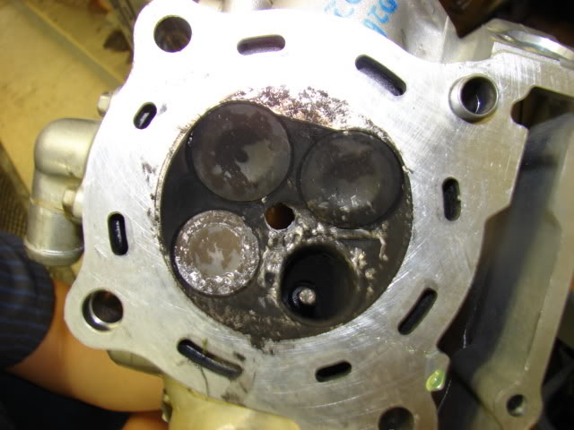

I know the exact noise your talking about, and mine did it too... and now doesnt...
FYI, if you call Kawasaki direct, you may not like thier suggestions.... been there done that....
My advise, find a shop that knows what they are doing.....
results of a shop not knowing what they are doing.....
Good luck.
