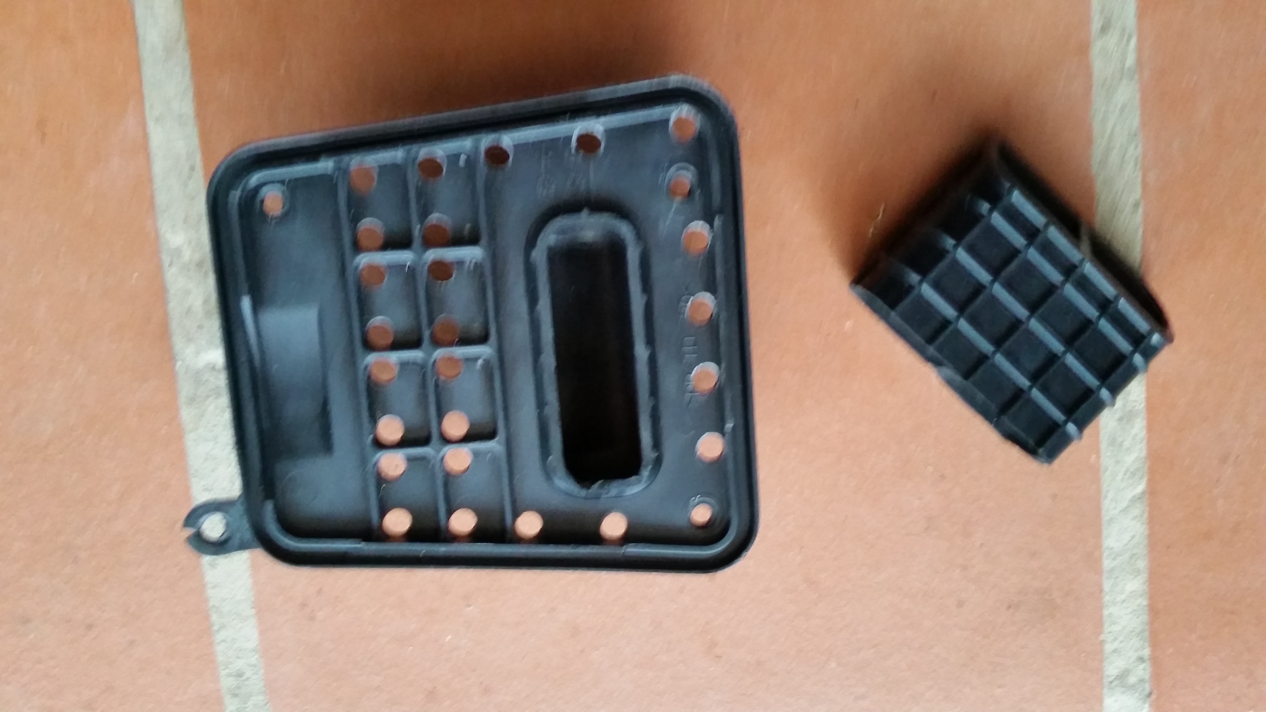

My theory for the airbox cover... I already have the high flow snorkel but i've read that
you get the best performance running the bike without the airbox cover.
So i want to cut the snorkel just below the cover and drill some holes in the cover for easier breathing. The snorkel would/should create some "ram air" effect while driving.
I'm not so concerned with water getting in the airbox as i don't do any river crossing or heavy offroad..

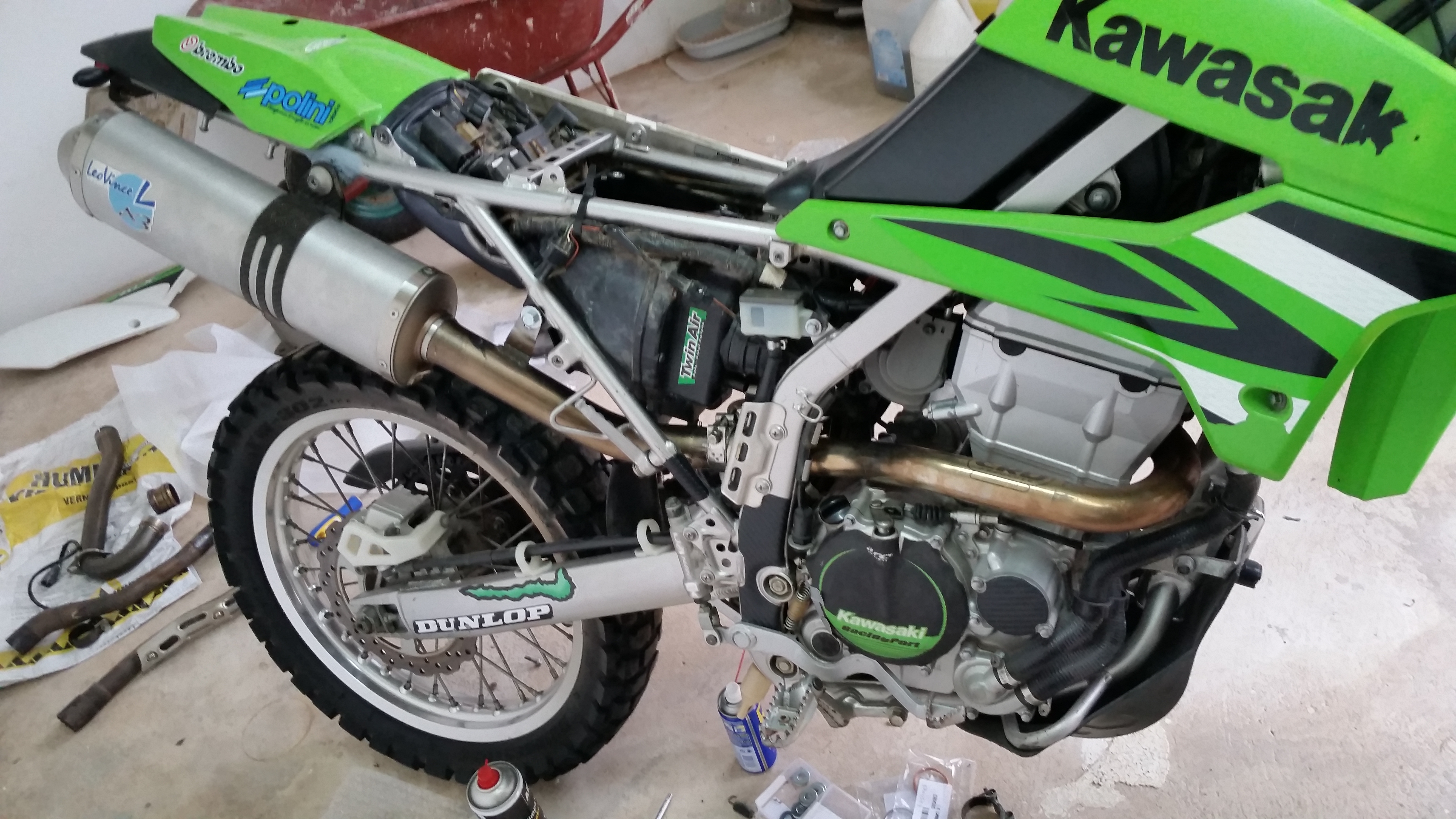

After working on my bike i have some good and bad things...
First the good:
-Twin air filter installed
-Exhaust > CRD header with the LX3 damper, sounds great! (I wanted to keep the silencer tip option instead of the Higashi)
-PowercommanderV installed (easy system!)
-Modified airbox cover
-Removed the secondary butterfly and the smog/air system
-ACR removed ( instant starting! hot or cold!)

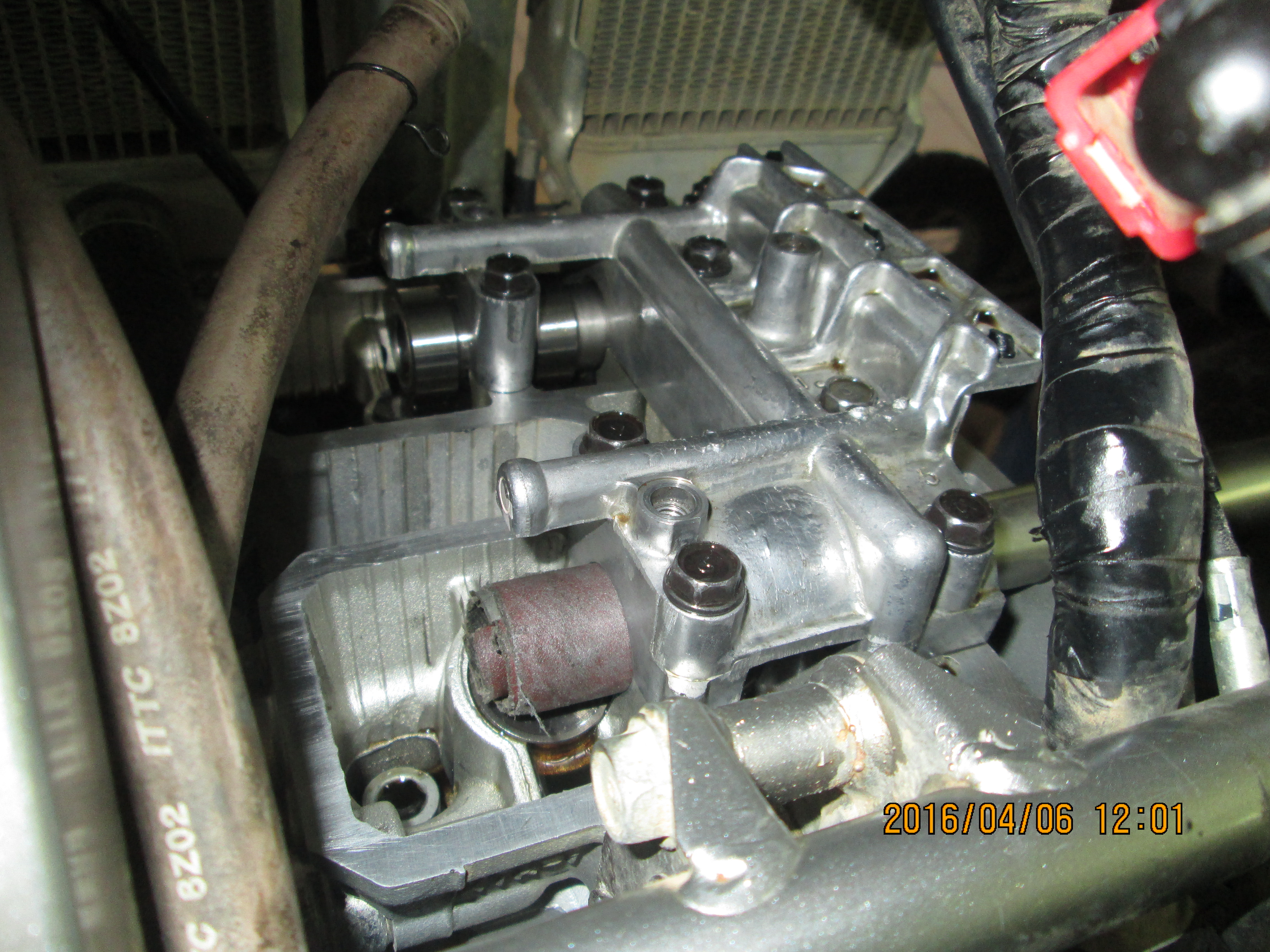

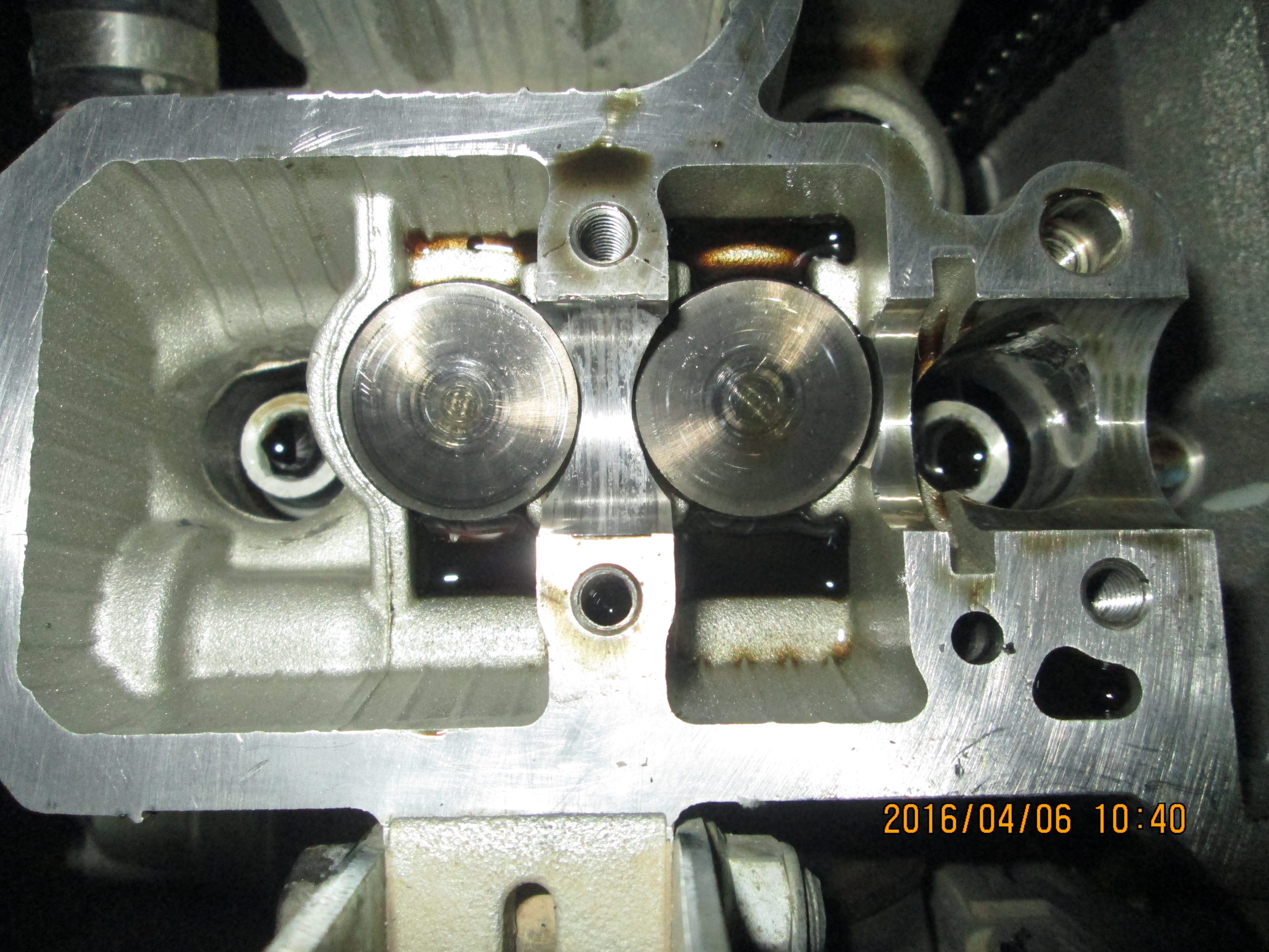

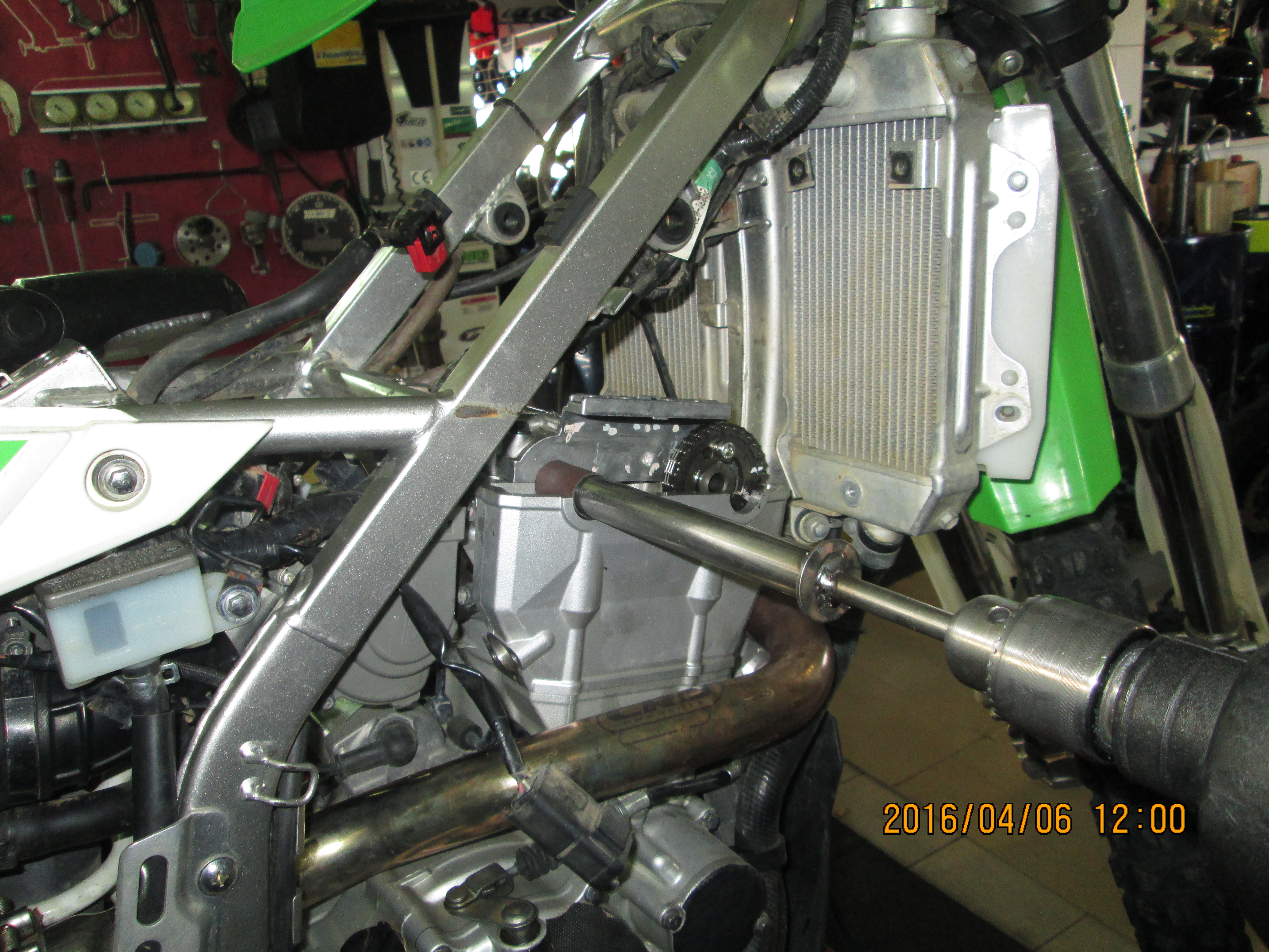

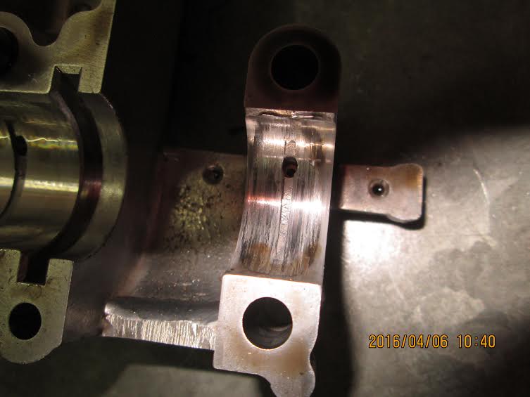

Had some work done at the kawa dealer because of the recall
While they did the valve adjustment they concluded some scoring on the cam journals and decided to overhaul it with sandpaper!
I'm not sure but i think it is time for a new cil.head...
What do you guys think about this?
I have no thots on the work they did on the head - it seems they had something in mind...?
Assuming your head is not destroyed:
Pull the airbox cover (there is no ram effect under the seat), load up this map - http://www.powercommander.com/downlo...17-023-502.pvm - and you should be on your way.. To dial in the bike any better will require a dyno - if you do the dyno tune, tell em you want a target WOT AFR of 12.8:1..

Klxster,
please do share your thoughts about the cil.head... Its abit more noisy when the engine is warm then before.. The dealer sayed that it is the chain and it will better when the chain is replaced(doing this in August+CCT) but i'm worried i have to less oil pressure due the increased cam clearance...
