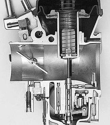

Looks like you've found where the problem is..
It should look something like this inside
