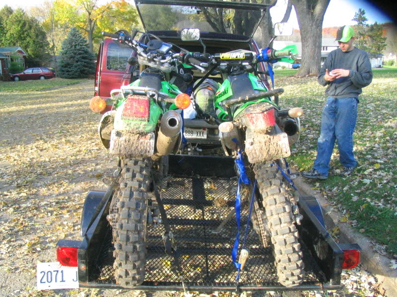

Since it came up, a 130 fits fine. I'm sure that it takes more hp to turn it , but I can't feel the difference. I put a 130 Dunlop D606 on to see how I liked it. I did two dual sport rides last fall with it on, and really didn't feel any difference good or bad. (no more traction , no less power) The only negative was that it cost ~$10 more than the 120. I'll just go with the 120 next time.
Mine is the "retarded" looking one on the left with the 130, the bike on the right has the same dunlop D606 tire but in a 120.
