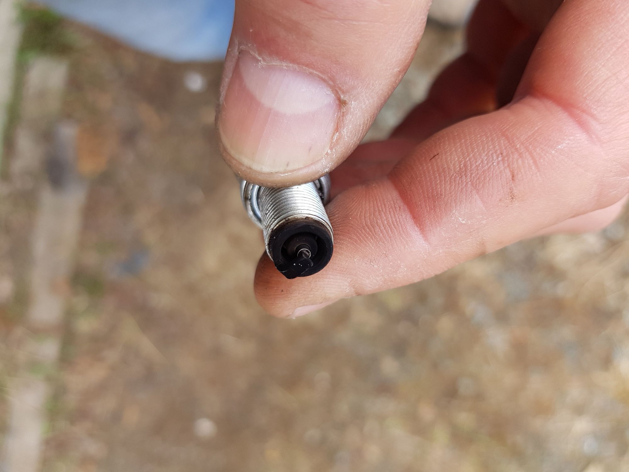

So I was going to put the N1TC needle on #1 slot but from my experience a move of only 1 on the needle would not be enough. Probably should have just taken the lid off. But I put the stock needle in and shimmed it with two 3mm washers (.110mm) which is about the equiv of 1.5 grooves. Solved about 50% of the midrange burble but still rich in that 5.5K range. Plug still showing too rich. The Picture was after 15 mins with the First Settings.
Not going to spend a crap load of time dialing it in because I live in a tiny town and the FMF has to go. I have a stock slipon coming. Gunna hurt the performance but got to do it.
Once I get the stock muff I think I am going to go to a #135K main, maybe 130K, stock needle shimmed .110mm and #40 with 2.0 turns.

There is precedent for the possibility that some "northern" CVK32's (on the KLX250S) will just not run larger jets.
If you are sure your slide spring is stock - uncut, therefore, stock length, and your slide lift port is undrilled, you should pop in a K138 main jet for a retest.
