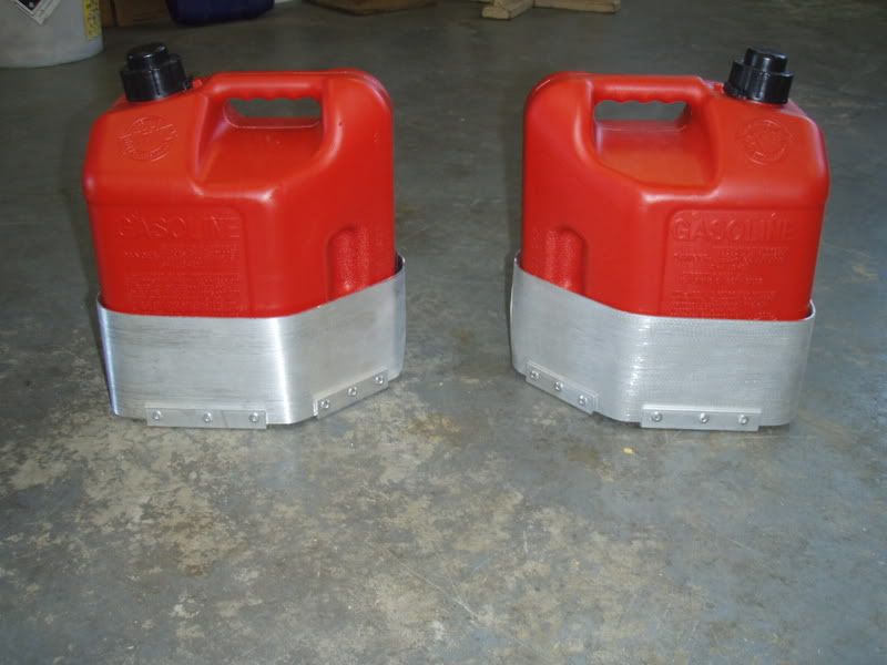

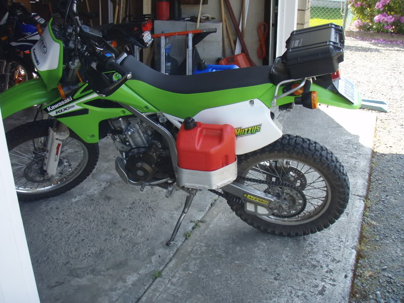

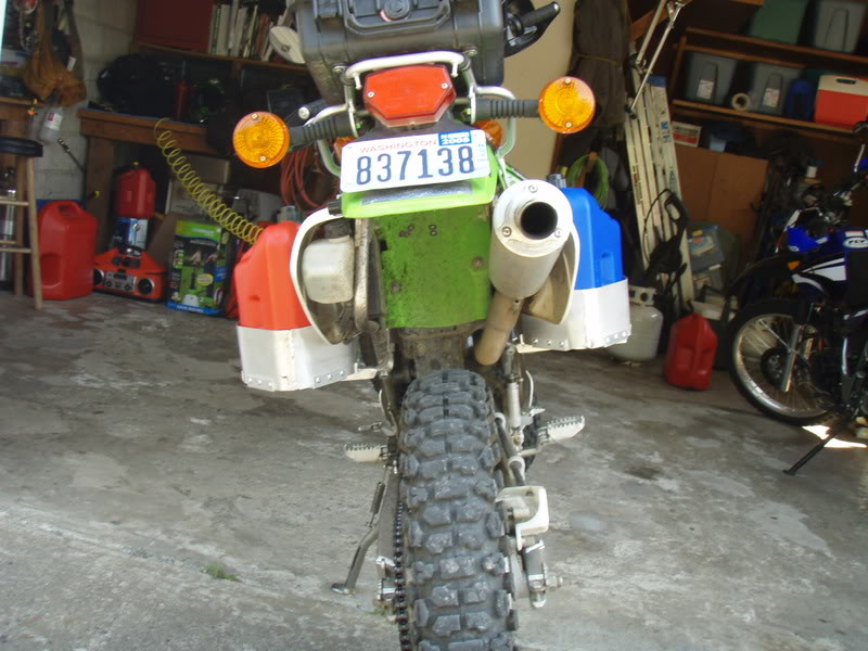

I made these a couple of years ago, they mount on the footpeg holes.

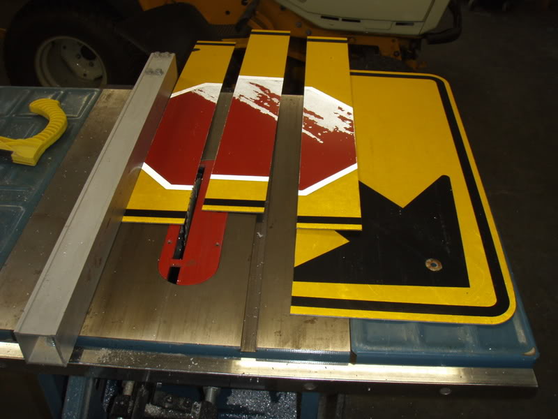

Started life as a street sign. LOL

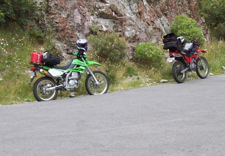

7.8 litres (2 US Gal), was made up for a 1500km road trip, worked well, could not feel the weight at all, would not us off the seal.
