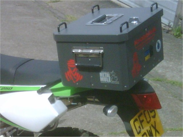

Fitted a Metal Mule box to my Nomadic rack.
Might not be to everyones taste, but it keeps my stuff secure and dry!
