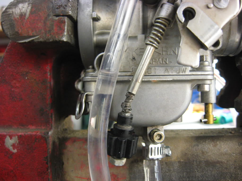

That's one reason you check the actual fuel level with a piece of clear plastic tube instead of just the static height of the float. ...........
Hey,
Thanks for the info. Can I ask, can you explain how you use a piece of clear plastic tubing? Thanks!
Old Aug 6, 2013 | 12:05 AM
TNC's Avatar
Posts: 5,050
From: Abilene, TX
Originally Posted by ssorange
Hey,
You get a piece of clear plastic tubing like for battery overflow tube or fuel line for a chainsaw, etc. Attach one end to the drain spigot on the bottom of the carb that has the black overflow vent tube. Gently bend the tube, no kink, and press the tube against the carb body at the area of the float bowl and carb body contact point. Unscrew the overflow spigot screw enough to allow fuel to flow into the tube. The fuel should rise in the clear tube to the point that the fuel is actually sitting in the carb. The fuel in the tube should ideally sit at the float bowl/carb body line. The shop manual shows how this method works, but using the clear plastic line lets you do the job without the factory special tool. When you know exactly where your fuel level in the carb actually is, you can either lower or raise the level as needed by bending the tang on the float where it contacts the needle.

and here's a pic
Very clever!!!! Thanks you guys! Nice picture too!
