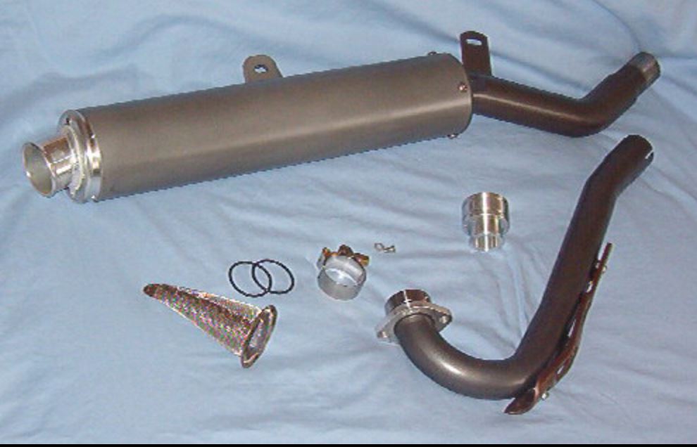

Default Found a Nice Pic.
KLXster, if I get it I'm half tempted to let you borrow it. Your help (and many others) and research has been invaluable.

Well, if you get it, we'll do measurements for a "best guess" CVK setup.
I've blown up your pic - I really like the system. That apparently "robust" heat shield means they went the extra mile to provide a fully engineered system for their customers.
They appear to have employed a simple revamp/recalculation of pipe size (O.D./I.D.) - no other "interesting" design features are apparent. This approach is just fine, it's "low tech" but it's also an old and established method of tuning power curves with solid math backed up with many decades of practical application verification. They have likely chosen a size that enhances power in the upper 1/2 of the RPM range - but I won't know until I have the detailed measurements.
You might check around for a Dyno shop that'll give your bike a quick run for under $60 - for AFR,TRQ,HP charts..
