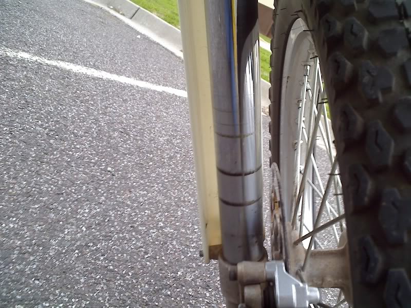

I tried that trick with the 35mm negative and got some crud out from underneth the seal. I went a step further by getting a pick tool and paper towel underneth the seal and got even more crud out. The left seal was the worst one, probably the reason why it started to leak. If the seal stops leaking, this will save me half the trouble and just enjoy the ride. The wheel bearing I will have to grease any ways when I do the tires.
This is how I discovered the leaky seal ^
Old Apr 24, 2010 | 10:58 PM
LearjetMinako's Avatar
Posts: 1,102
From: Oklahoma City, OK
Took the KLX for a good bumpy dirt road ride. That left fork seal is gone. Even after cleaning the dust seal, oil is still smearing out. This time it is clean oil. So I guess I'm going ahead with the fork seal replacement and spring upgrades.
