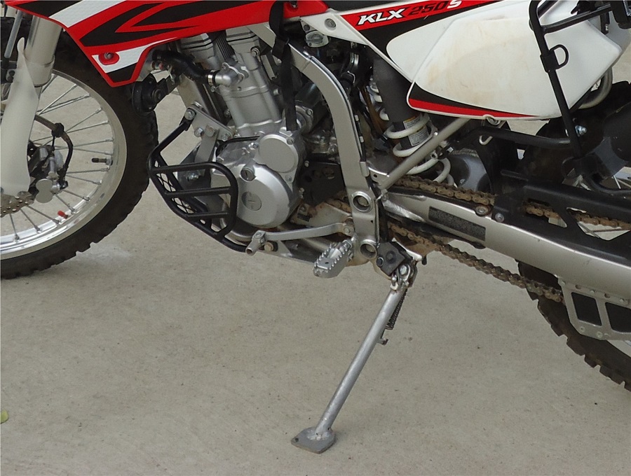

I took the easy way out and cut the stand off/welded a new plate. Getting the right angle on the bottom of the tube is the toughest part. If someone is going to do this cut it a little long first to test your angle.

Originally Posted by DYNOBOB
Nice work Bill.
Dude that's pretty nifty!
Nice work Bill.
Thanks! Yours looks great, like it came from the factory that way!
