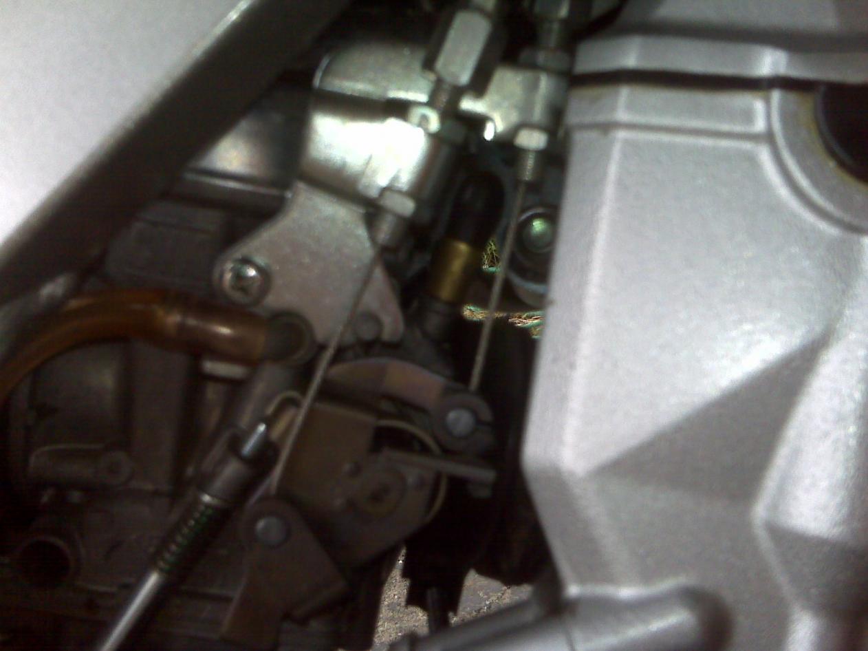

I am in the process of removing the smog stuff off of my 50 state 09 KLX250S and I am not sure what this is or if I routed the lines right. I couldn't find any pictures of it in this thread. The line on top comes from the gas tank and I blocked the other line (it went to the smog canister stuff) and the line on the bottom goes to the carb. I will post a pic of the carb too.

Well, I wasn't smart enough to take a picture before reinstalling the carb. This is where the T is and you can see the line I blocked and the line coming from the mysterious canister comes in on the other side of the T.

So, can I remove the separator pictured 2 posts above (post 61)? I think the gas tank overflow connects to this since gas came out when I had the tank off and tilted it too much. It's connected to my carb and I would like to remove it from the carb if possible. Plug it at the gas tank? Route the hose down to the bottom of bike to drain?
I'll have to double check mine. I have the front one to open air (tank vent) the second one is capped, the third one is the overflow long tube to be routed with the other overflows and the two fuel outs. Like I said let me double check it.
Old Jun 13, 2010 | 06:32 PM
  #65
RaceGass's Avatar
Posts: 1,392
Yes, route the TWO tank hoses to the same location as the carb drain hoses

Ok had a chance to look @ it.
Front to rear on the tank. (on the bottom of tank the lines are identified by dots of color) Blue is a vent line that can be ran to the vent lines off the carb with a "T" or by itself. (I just used the hose that does a 180 degree bend that was for the smog junk, came off the red port. Mine does'nt go in the dirt so contamination is not an issue but I may still put a filter on it) I capped the red line, this is a vapor return to the tank that was connected to the small smog apperatus that was mounted near it, it will spill fuel so I capped it. I do not sugest running it to the carb vent lines because it will waste fuel periodically. Next is the uncolored long fuel filler spill over flow tube that needs to stay routed with the carb vent lines. Yellow goes to the #1 on the pet **** and white goes to the @2 on the pet **** and the out is to the carb supply.
Hope this helps.
