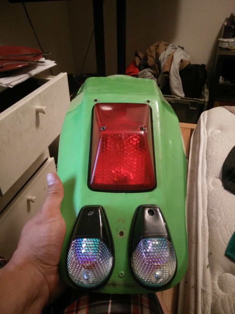

Pretty sure mine had a battery but I don't really want to add one back if I can run lights off the stator + capacitor.
Might get a big MTB riding light in case I get stuck out in the dark.
Got my signals on my fender. Not the greatest look but 10 bucks for both, and 20 for the stock light with the parts to make it dual filament.
