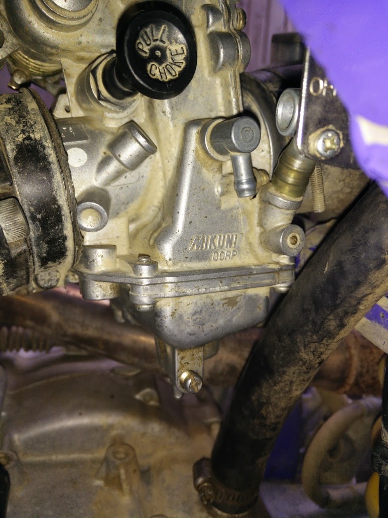

Ita got no airbox lid, a mikuni carb, and FMF exhaust. Wondering what I should be running for jets as I'm not sure the po tuned anything or dealt with any of the mods properly.

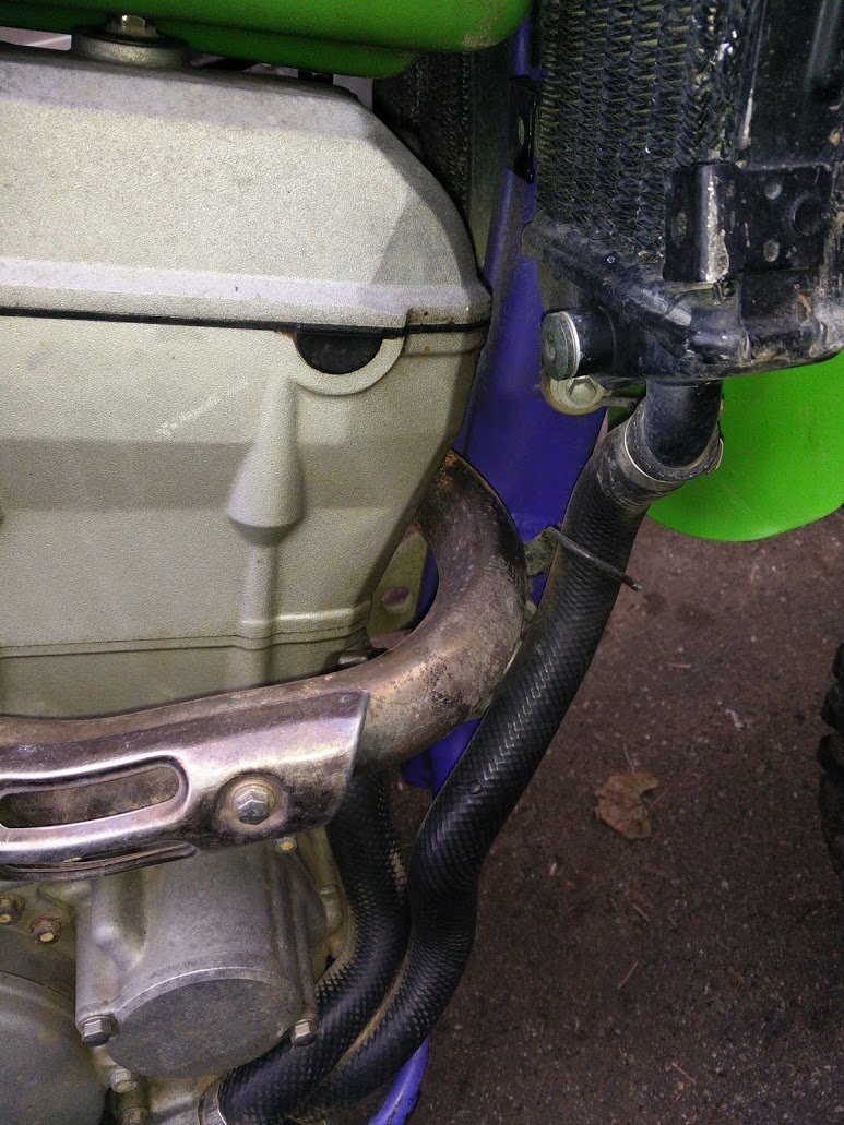

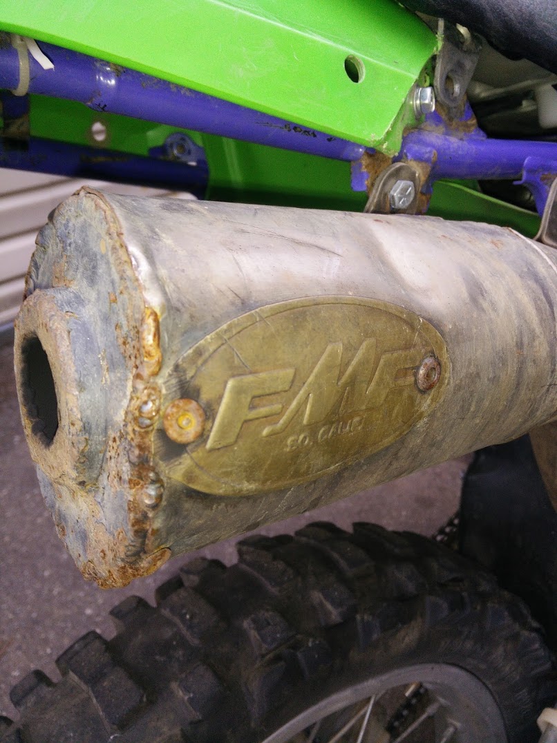

Im also confused about the exhaust. What is this abomination? Why would they cut and reweld it? Can I make it more stock? Potentially quieter?
Is this the stock header?
Also how do I identify what mikuni is on here?

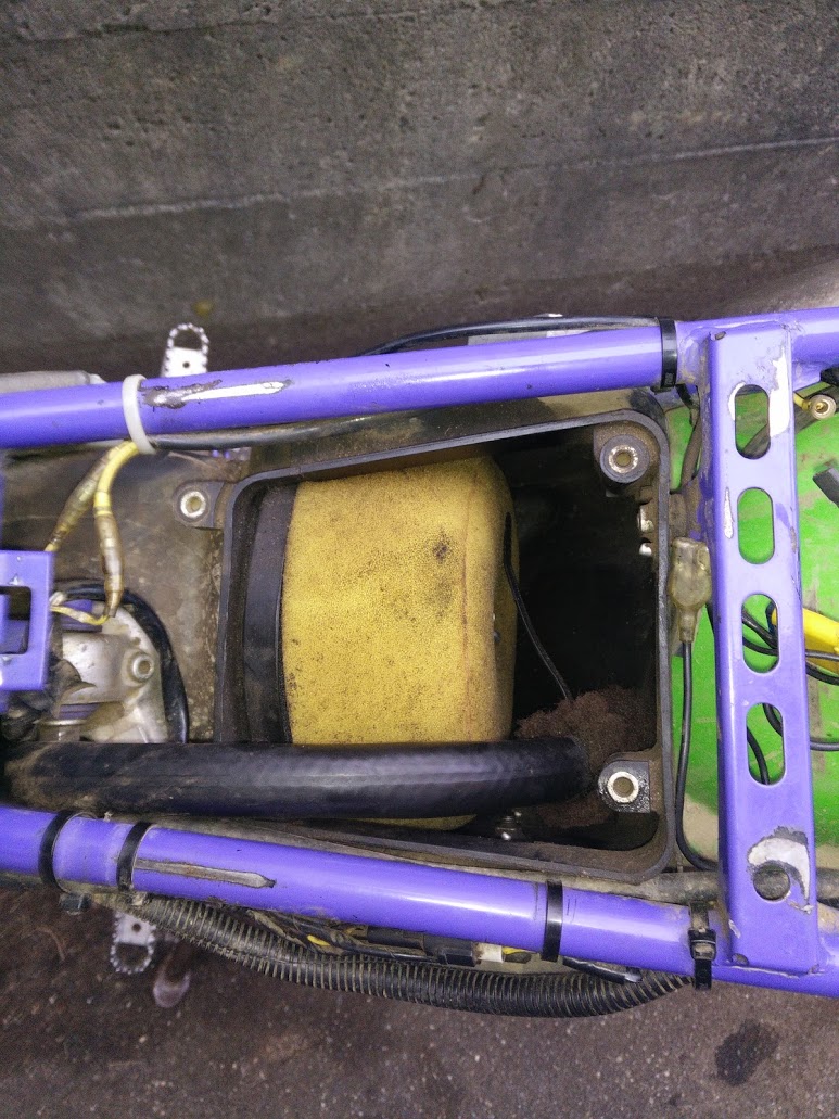

Is this the normal airbox setup? No lid, no snorkel, big foam filter? Is there a better filter I can put in?

I don't know what to tell you why the PO did that to the muffler. Those need occasional re-packing of the fiberglass packing material which typically involves drilling out the rivets, pulling apart, install new packing, then new rivets. I'd say it's probably trash and you want to look for a used stock or aftermarket unit. Ebay is your friend. Spend some time looking to see what other models will interchange (perhaps a KLX300). Or run it as is.
That looks to be the stock carb. Probably not a bad idea to pull it off, give it a good cleaning and check the jets.
Lid off the airbox is common. I run without one. You can see the PO put a larger breather hose on the crankcase vent and ran into the airbox, which isn't uncommon.

Oh, and to your air filter. Yes, that one looks correct, but what condition is it in. If the foam is old, cracking, ripped, sloughing off in any way, replace it. I like the Moose Racing and TwinAir filters.

Look here for carb id. :KLX Hop-Ups*-- PUMPER CARBS Looks like a 33mm Mikuni, not stock.
Identify the carb and we can help with jet sizes.
The outside diameter of my aftermarket header is 1 1/2". Can't find the stock header to measure it.

That site is pretty informative found it before! Thats why I was pretty sure it wasn't stock and fairly certain it is the Mikuni 33.
My header is 1 1/4" (1.3" at its widest but its not completely round)
Air filter seems good... Looks and feels like memory foam really weird. They seem cheap so may try and grab one when I'm in the USA next.

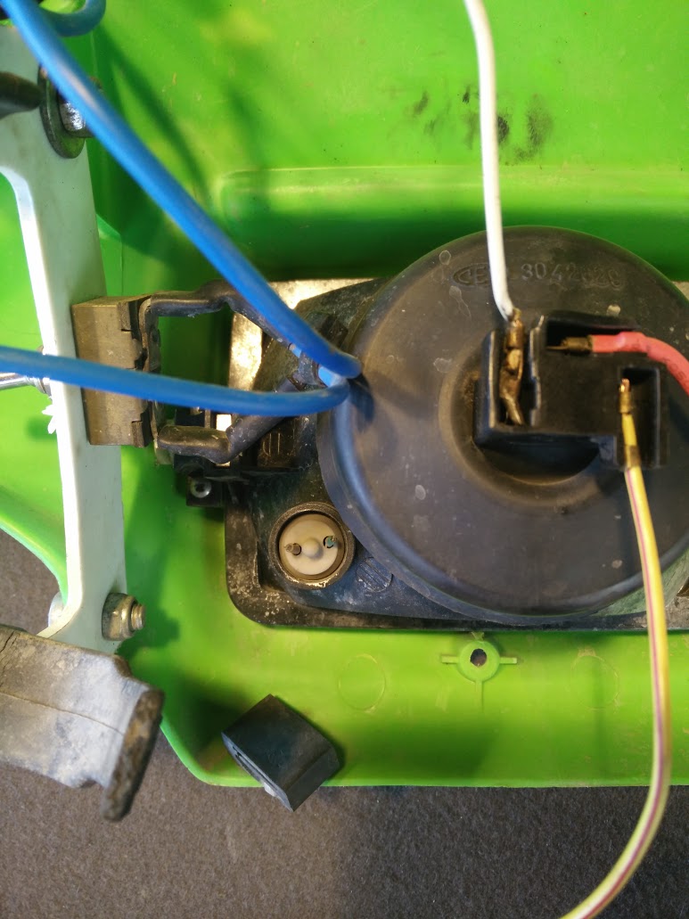

Will try that today. Have the thing apart thinking about adding a battery in but not sure if its worth it. Mostly thinking of doing it so it has enough juice to run headlight tail light and indicators to street legal it. Maybe I don't even need one and the capacitor is fine... No experience with capacitors
Managed to find a dual filament fitting and replaced the original rear bulb assembly so I can even have a brake light.

Just read that people cut the mesh in the airbox. What does everyone think of that?
Just did a coolant flush, oil draining now, and also cleaned my air filter with some soap and water looks good as new.
