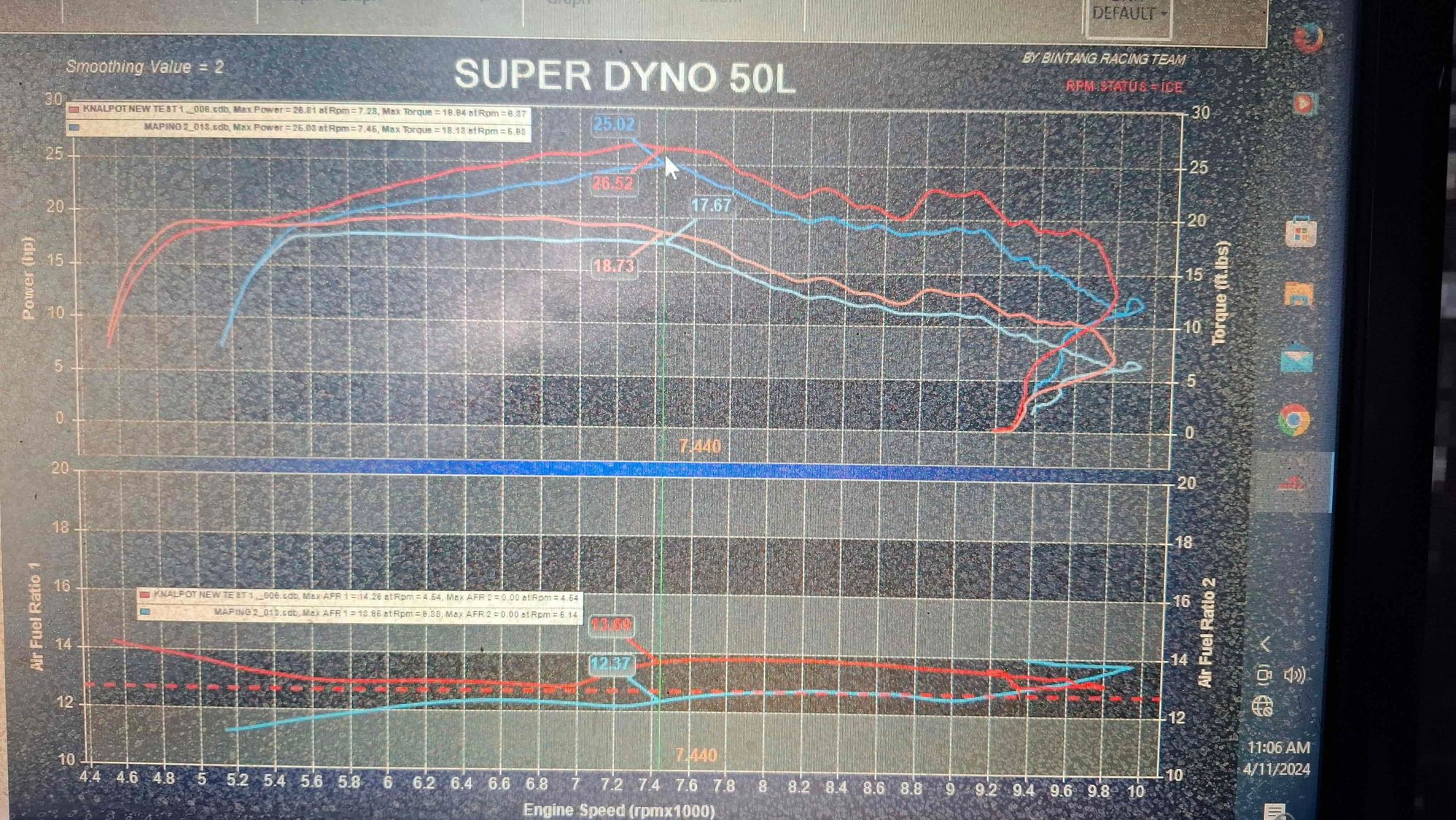

Hey folks. I have new portion of dyno runs. I made full custom exhaust with megabomb style header and also wanted to try MCM at the intake cam.
First run is new exhaust compared my previous set up (300cc AHL kit, KDX snorkel, no secondary throttle, modified stock muffler where I replaced end "straw" pipe with 2.5 cm pipe)
25 hp vs 26.8 hp. Not bad!
I decided to see what will happen with open airbox (lidless). 28.5 hp! See pink and green runs below:
I tried intake cam mod (partial MCM) on top of it, but reverted back to stock cam timing. Cam mod gave slight edge in torque below 6500 rpm, but can't maintain it after. So with intake cam mod bike makes 27-27.5 hp at 7500 compared to 28.5 with stock cam timing.
There is possibility to unlock more power with the same hardware, but it will require tuning ignition. On the graphs below it's clear that torque drops from the cliff after magic 7500 rpm. I believe this is what Kawasaki has done to detune bike to meet emissions. With proper ECU (apitech?) it should be possible to get 30+ hp at 9000-9500 rpm.
Again
24 hp at 9000(!!!!!) rpm
