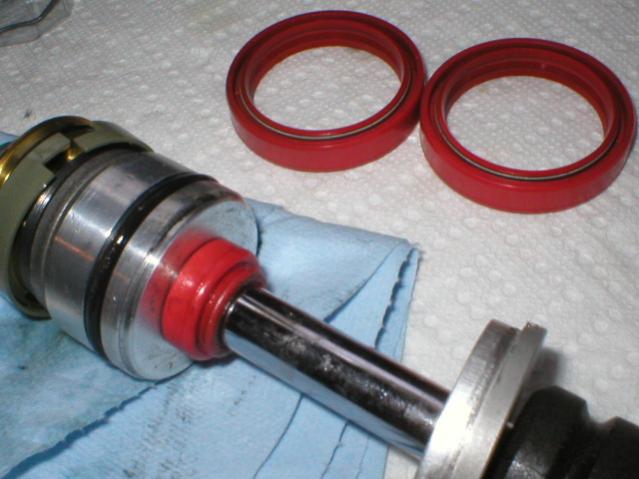

Last year I installed a set of those red All ***** fork seals in my KLX when doing the Gold Valve deal, and they lasted about 3 rides. Shortly afterward I learned that these fork and seal head units didn't have a good track record. Well, the seal head made it almost a year. I just replaced the seal head with a KYB unit from Race Tech. Here's a pic of where the All ***** unit failed, just like Rick at Cogent Dynamics suspension told me it probably would. See that nice little tear on the inner seal? Nope...not because of a dinged shaft or burr. Rick said the design allowed that inner seal to fold or twist in a manner that could cause this.
MSR and I believe Moose have been marketing these fork and shock seals under their own label, and maybe some others. I'd be leary of any red seals out there until you can guarantee that this has been corrected.

One of the shops that I inquired about suspension work told me flat out. If you have those all ***** seals, we won't put them in for you. My experience with other all ***** products has not been positive, so I avoid their products.

Thanks for the heads up on the All ***** seals, I'm looking to having to do mine in the near future. The film trick is just not cutting it anymore.
