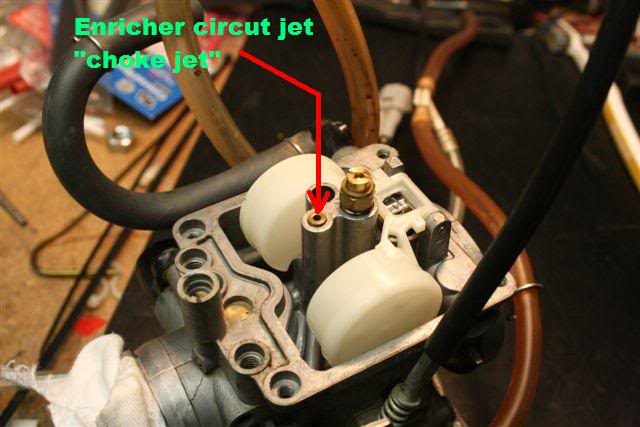

A search should bring you more info on drilling the enricher (choke) jet if you need it.

Dan88, How deep do I go, on that choke jet when I drill it?

I put the bit down into the jet and when turned with the hand-held bit driver could feel it grabbing, removing a little material. I think it went down maybe 1/8 inch or less before breaking through. You'll feel it.

What IDRIDR said ^^^^. Make sure you use a pin vise (or similar tool) to hold the .018 bit. I used compressed air to blow any chips out from the other end of the enricher circuit.
