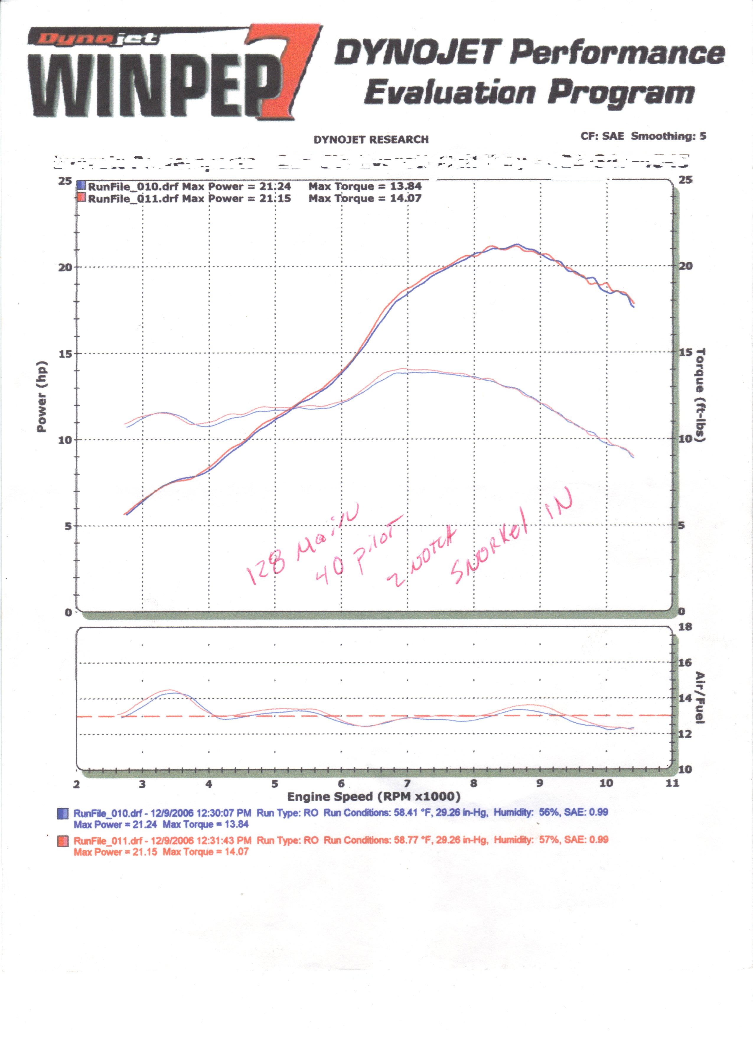

thanks I may have mathematically calculated the OL wrong for the mod. I did however have them positioned correct. The 1st time I did the int cam only, 2nd time both. FWIW the stock .050" spec is. intake 2.5/37.5, exh 37/5, zero OL, duration 215/212 measured by webcam. The intake closing time is the most important timing event. Stock it is about where it should be. Modded it moves too far, closing to soon for good fill. That's exactly how it runs too, despite any increase in OL. The increase in dynamic compression from the early closing gives it some more felt power down low, but in my case takes away the strong pull at redline on top. This was more noticeable when I put it all back stock. Where I did think it helped was in slow trails, maybe using a gear higher roll on. just my 02, has been a few years since messing with it.
my bike is a 06 250, here's what it looked like new, rejetted with a kdx snorkle and 300 exh system. Sort of my baseline as I played with K&N filter, lid off, big gun pipe, cam phasing, offset timing key later.

You should know that, best I can tell from a few years of researching performance modded non-MCM KLX's, they seem able to make about the same peak HP, but 2 lb.ft. LESS torque.
Since the TRQ curves on non-MCM and MCM bikes is a nice bell shape, this +2 lb.ft. at peak creates a HUGE difference in performance.
Also, you should know that a measurement of TRQ @ 9500 RPM between your chart above and my latest run shows you almost to 11 lb.ft. and me at 13 lb.ft.
Since you are looking for power level increases around redline (10,500 rpm) and a TRQ ramp-up closer to redline, I can understand why you could prefer standard timings even though the dyno charts indicate otherwise. The "earlier" MCM midrange "hit" is so strong that it "masks" the fact that more power is also being carried to redline.

Thanks for posting your chart. I'm having a great time analyzing it.. It looks like a DJ128 does a pretty good job of fueling with a snorkel below 8200 rpm. That "lean-out" 8200 - 9200 hurts - probably a lotta MOPOWAH could be created there with an proper AFR.
