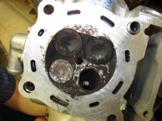

this happens if the piston hits the valves...

Wow EMS , the poor head , it looks like it was young too ... RIP .
Thatīs why : Please exercise great caution when doing timing stuff , check and double check your positions , tensioners , use threadlock on the cam bolts and donīt be ashamed to ask if you didnīt understood something .

EMS,
What is that head from, your KLX?
