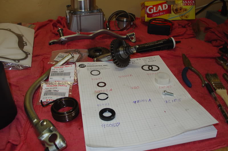

I didnt see where all these parts went after this pic
and Im not too clear about the 3/4 tension on the spring, but other than that its a great write-up. Thank you.

The kickstart shaft has a hole drilled in it.....one end of the spring goes in the shaft.....the other end of the spring gets shoved in the engine case....... you rotate the spring to maintain pressure on the shaft so it flicks back up after you kick it. I don't know how else to explain it.
