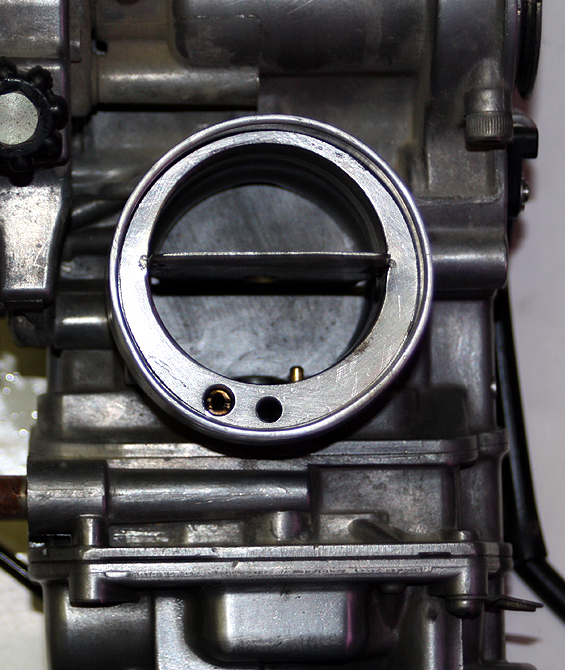

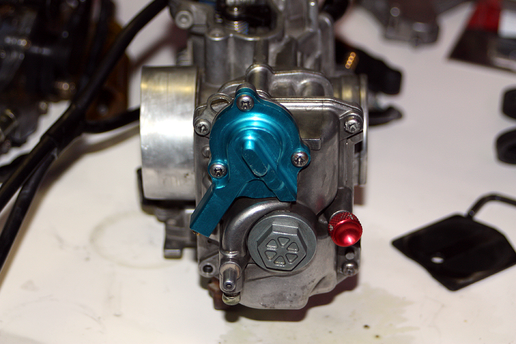

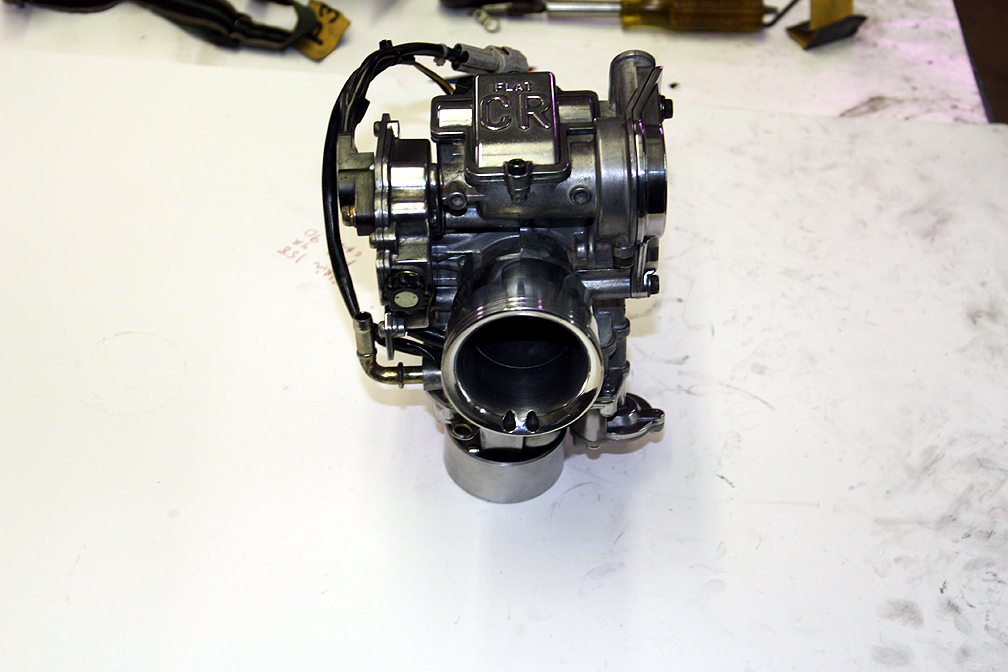

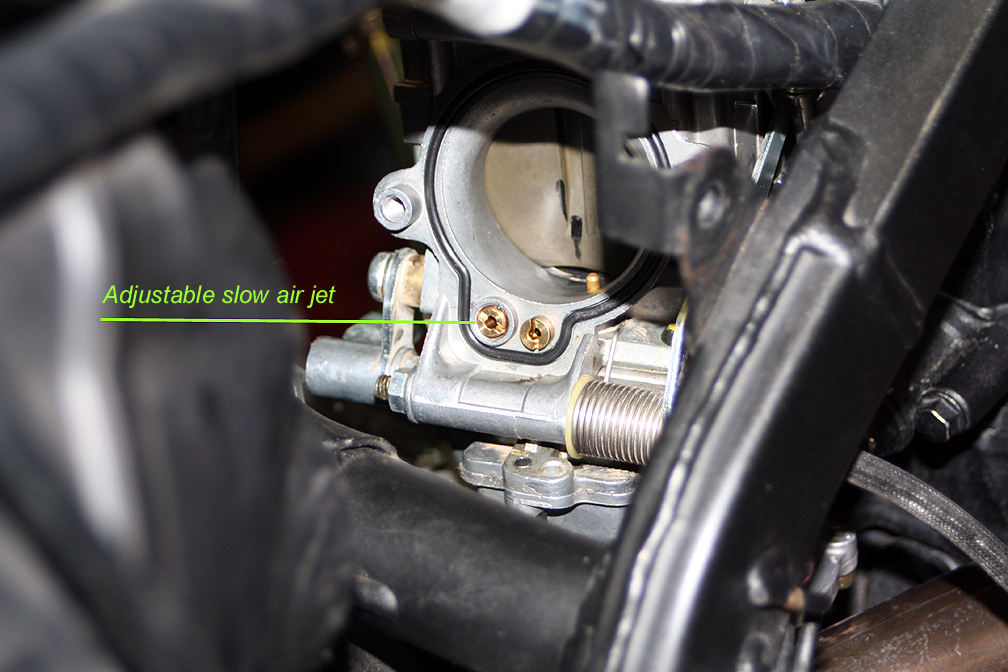

but you can install a merge racing adjustable leak jey
and a scary fast power now
and different size volicity stackx
and on the sudco fcr it comes with ever so cool adjustable slow air jet
now you have enough stuff that it will take days to get it in tune

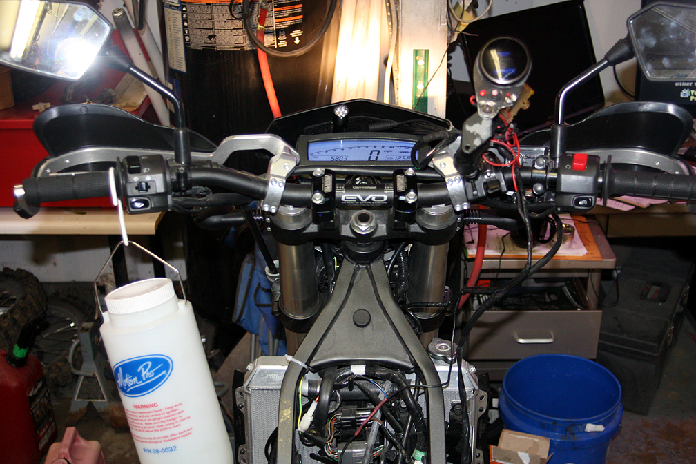

Day one of tuning
box full of jets and needles and at the end of the day
have to get more needles and jets
Starting out with a blank sheet of paper.
