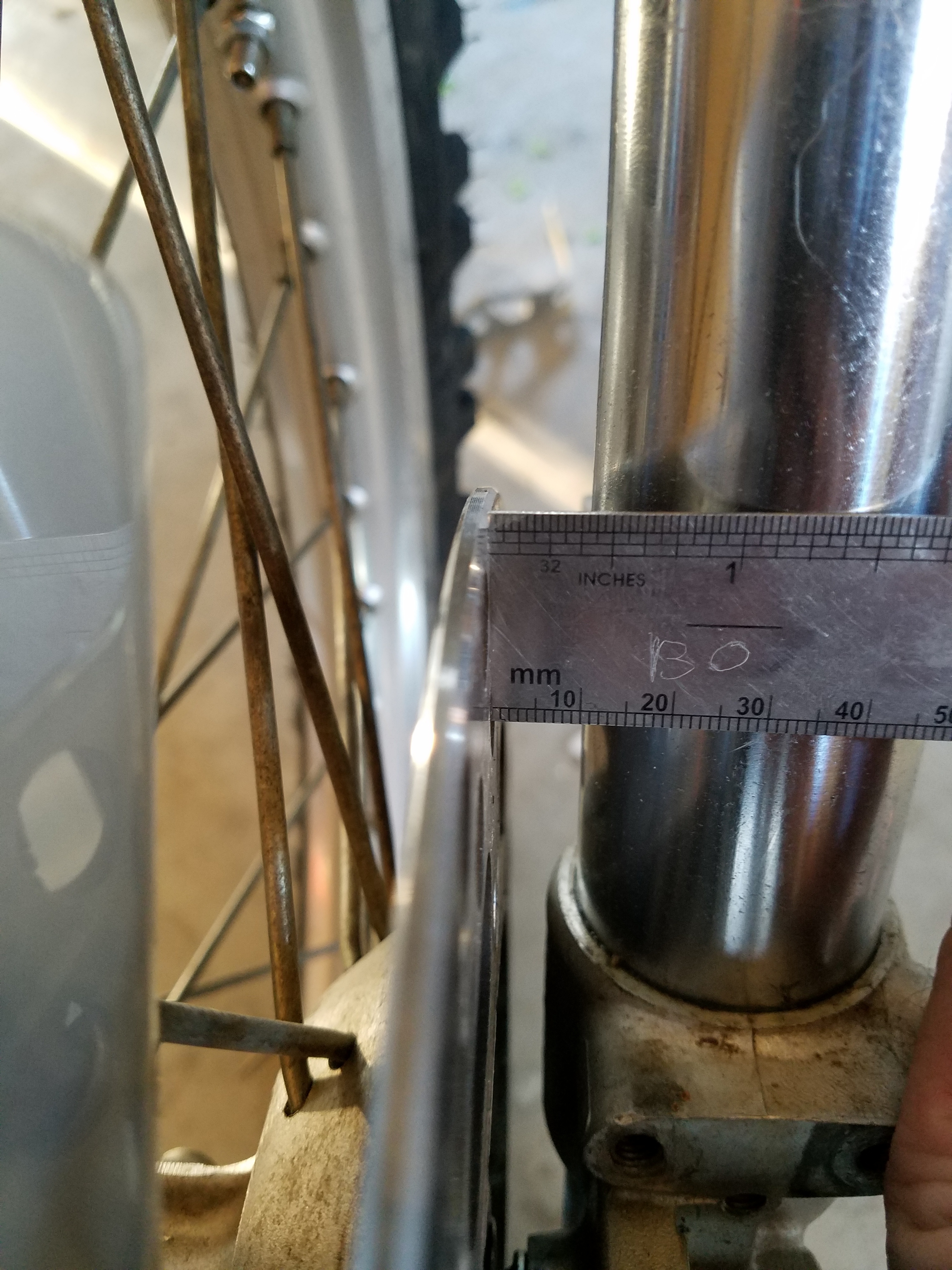

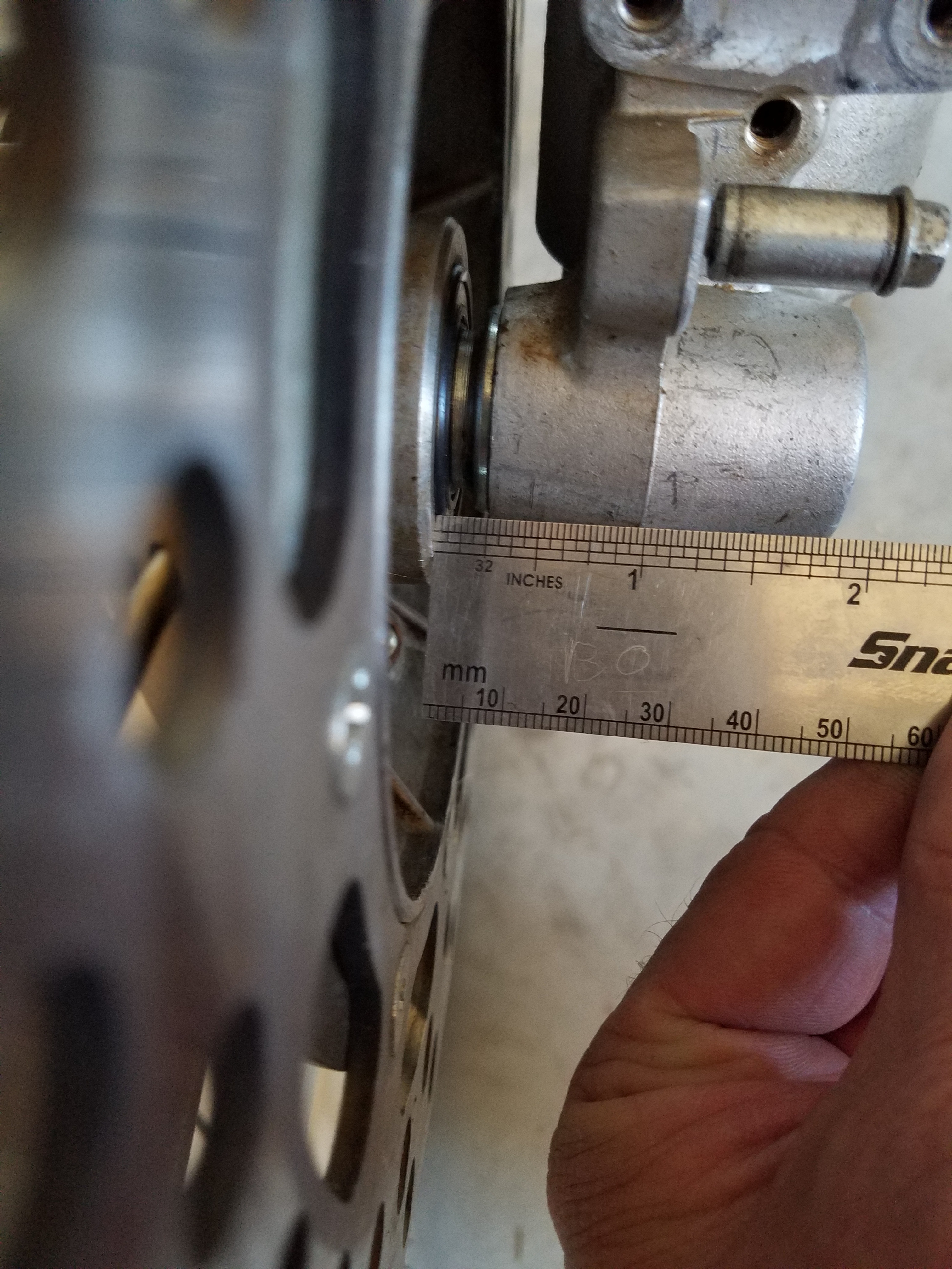

Hey all, I bought a front wheel from a 1989 KDX200 to use on my 1997 KLX300.
My KLX300 caliper doesn't seem to align with the disk on the KDX hub.
Could someone please take a look at the measurements in the attached pic's and check them vs. your KLX300 or, I assume 2006/2007 KLX250?
I would appreciate it thanks.

The best way to do that, is put your new wheel on without any spacers. Then with the brake disk in the caliper between the shoes, pull brake lever in and zip tie it so brake is on. Then measure each side and make the correct size spacers.
