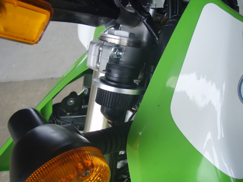

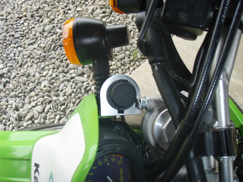

I added a 12v socket to my bike as well as my wife's bike. Then I made a reverse plug to connect the two in case one of the bikes got low on battery power or a key was left on. In the MSF class that my wife took they taught everyone to use the kill switch to turn off the bike. WRONG!!! I have never use it and told my wife to do the same. You hit the kill switch and the headlight is still on, you step off the bike and get distracted.....well you get the idea.
This is what I made and it works great. Tested at home. A year after buying her bike the battery crapped out. So I bought a new one and added a kick start to her bike.
But this is still a great back up.
