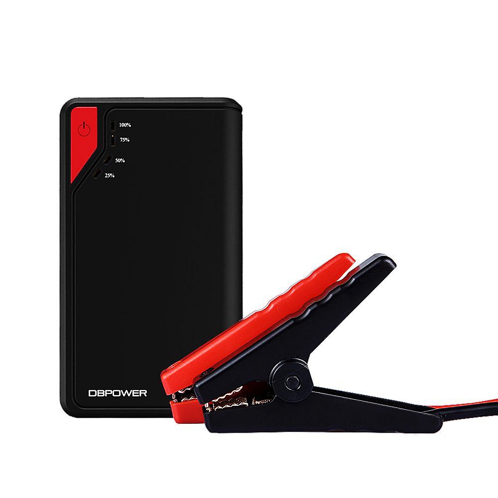

I picked up a couple of these this fall.
https://www.amazon.com/gp/product/B0...0?ie=UTF8&th=1
It uses an "EC5" connector commonly found in a R/C hobby application to connect the alligator clamp leads to the lithium battery. I bought some extra EC5 connectors and 10AWG wire and made my own short pigtail and hard wired it to the KLX battery. I made it just long enough to hang out right behind the side panel so I can access it without removing anything. Looks something like this:
https://www.amazon.com/E-flite-Batte...7&keywords=ec5
Iirc, the EC5 connectors are rated to 150A, so plenty for the tiny KLX. I wrapped the connector with a little electrical tape to keep water and junk out of it. One thing to remember, however; it's a nonfused pigtail with large diameter wire, so the potential for a nasty short directly across the battery is there, if the bike was ever dropped and heavily damaged on the left side.
