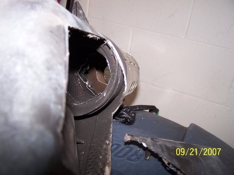

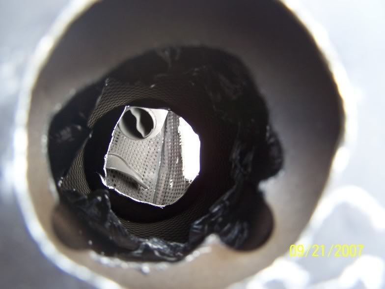

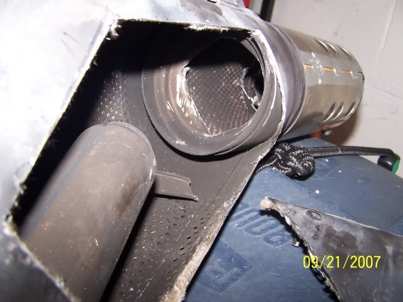

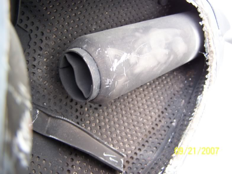

You should check in the "inlet" pipe that dumps into the first chamber of the muffler--that is where it would be. Try fishing something from the headpipe connection into that first big chamber & see if you hit something.It would be a honey comb type structure inside that pipe, probably only an inch thick or so.
Glad the muffler arrived safely.
Old Sep 21, 2007 | 11:52 PM
zapitbullseye's Avatar
Posts: 79
Default RE: The Jig Is Up! See pics.......
OK, here it is, all opened up. I can see inside the inner tube, even with a mirror, and there's actually a baffle inside, with a plate that runs down the length of it. Not restricted though. It is the same diameter as the pipe. Should have it all welded back together with a nice outlet saturday along with a bigger jet.
