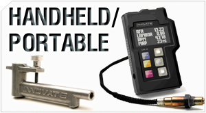

Another thing to consider with the A/F meter-if the air injection in the exhaust isn't blocked off so that it can't allow any fresh air to enter the exhaust your readings are going to show leaner than the actual mixture in the engine. Also make sure that the tip of the probe is inserted as far into the pipe as possible to prevent any reversion skewing the readings.
yes the air injection was still connected using the meter but klxster said my readings was the same he got on the dyno and he doesnt have that stuff connected
So if we both had the same readings I dont think that was the issue
the probe was around 16 inches long
this is what the guy had bought originally and its only like 8 inches long the o2 screws directly into it
but this is more for car exhaust pipes just clamps on with a set screw
but for small bike applications this wouldnt work as is
I said to mount it on the muffler with long springs but they ended up making what I used
