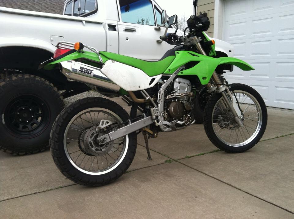

I have an 06 and i used the 2206 Dyno Jet kit and it worked fine . Both bikes run the CVK34 Carb
Dynojet Jet Kits - Offering Motorcycle Jet Kits & ATV Jet Kits
