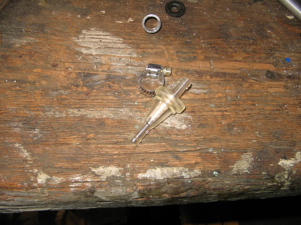

Well most of the newer memebers might not know but from what i understand there isnt a fuel filter on our bike. So while i was at the dealer buying the 2 year extended warranty for $296.80 ( the dealer was 40$ cheaper than the paper i got from kawi in the mail). I was lookin around and he had inline fuel filters so i picked one up, and installed it today. I also did the carb vent mod, Thanks Deej! Here is a few pics of the fuel filter.

I also took the white sticker off my front headlight plastic, i dont like the white....

Sorry about the pic sizes... photobucket didnt resize again...... grrr......

Although they probably won't filter as well as your add on unit, the KLX 250/300 non S models have filter screens on the petcock that must be inspected and cleaned periodically. Many people forget about them. I don't know if the S models have them or not.

works great went for a little ride..... didnt get a chance to try out the carb mod yet though......

Ok, gang. There is a filter in the plastic tube that enters the carb.

I think I used an o-ring pick. The filter is a conical shaped plastic mesh, be careful.

did you take yours off with the carb out? or do you think you could get it while on the bike still?

On the bike. PIC
