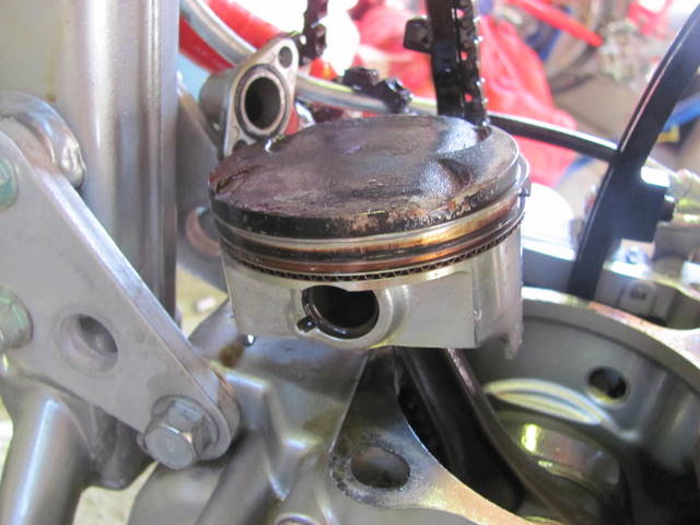

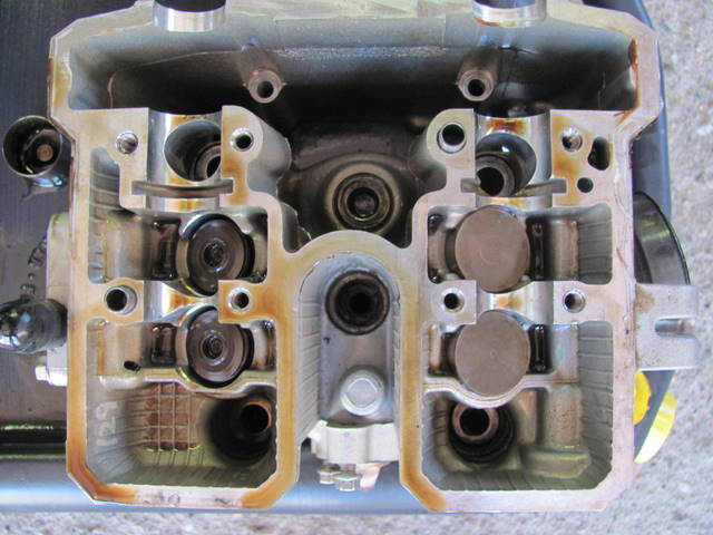

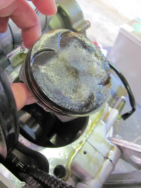

Here you go. Nothing super obvious to me. I don't believe there was coolant in the oil but I changed it this morning and after sitting in the engine and trying to turn it over maybe 5 or 6 times it came out somewhat dirty but it didn't seem watered down with coolant. Most of the coolant came out of the raidator and exhaust when I was taking the bike down. I suppose some may have one in the oil but it wouldn't have been a lot.
So does anything look unusual in the pictures? I don't see any cracks or breaks. The gaskets all looked pretty good. I tore the one on the bottom of the cylinder when removing it but it was intact prior to that. The one thing I noticed was alot of carbon build up on the piston face and around the bottom of the valves. I can not push them and get them to budge at all. I would think that this was a bad thing.

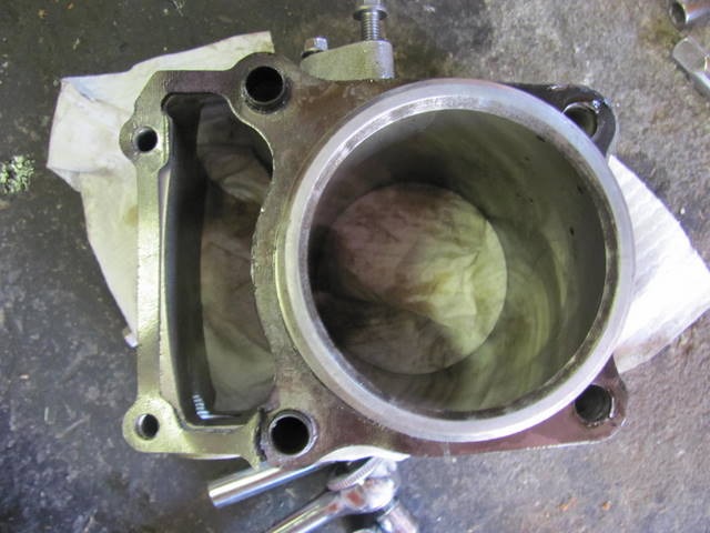

Default And one pick of the bottom of the cylinder
That is a rip in the gasket, not a crack in the cylinder housing.

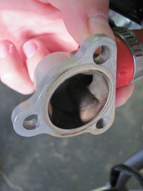

I'm not the expert but it appears to be a head gasket leak near the top of the third picture. That thermastat looks like it has failed also.

dacoontz, we won't give you too hard a time...sounds like you have enough of that without our help. On that hose housing part you're showing in the third pic, I'm still not getting the deformed or out-of-round part of your description earlier. Maybe I'm just missing something in your pic.
As far as something being cracked, I'm betting you'll have a head gasket issue instead. The only other problem might be a warpage that you'll want to have someone check on the surfaces where the head and cylinder meet. Yes, you could have a crack somewhere, but it's down the list of likely possibilities.

You should not be able to push the valves down with your fingers, those are pretty strong springs. I notice the caps are off of your two exhaust valves. Be very careful that you don't lose the shims!! I see one stuck inside one of the caps.. Do yourself a favor and put the caps back on, be sure the shims are seated correctly, and then stuff a clean rag on them, and tape it down.
To clean the valves and the piston head, get yourself some seafoam and a COPPER brush. Dip the brush and scrub. Be gentle on the valves.
Now the bad.. From what I can see, you definitely need a new head gasket, new thermostat, and I would also replace the piston rings.
You see all the carbon blow by under the top ring? I don't think that should be there. I just ran down and looked at my 250 piston I pulled, and the surface is covered in carbon, but there's no carbon past the first ring at all.
I'd start with those three things, flush your oil real good, flush your coolant with distilled water/vinegar, and cross your fingers that that's it..

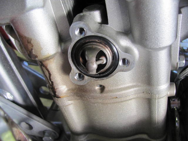

Sounds good guys. With the thermostat. Are we talking about what I have pictured below? How should it be seated exactly. And the thing i was mentioing about the part is how the the picture below shows a round opening from the engine but the elbow that bolts onto it has one side that is not round. Because of this there isn't the best seal there, granted it didn't have a problme before all this went down anyway.

I think you have some luck on your side. You've blown the head gasket and run her dry with a faulty thermostat and still have a serviceable bike.
These shots clearly show the blow by from the cylinder into the water jacket Just above the exhaust port.. New head gasket for you my man.
Looks like there has been little or no contamination of the oil (very lucky) and despite the faulty thermostat and the "cook up," the head, valves and cams haven't suffered.
Fit it all back up together with new thermostat, top and base gaskets, fresh oil, filter, and coolant and it should run sweet.
Just read Larrys post and looked at the pictures again, and I too agree that some new rings are in order so add them to the parts list.

I would not worry about the flat side on that elbow. The seal is not made by the whole fitting only the innner discolored part. You should be good but I would recomend you evenly torque all three bolts in steps when you put it back together. If you torque 2 of them down all the way with little to no torque on the third you can **** the fitting a little and less sealing pressure will be applied near the third bolt even if they all have the same final torque.
