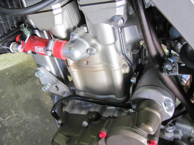

I have a feeling something is wrong
So the heating issue started after installing the new hoses? I'm still not clear on the description of the non-circle part of your housing, but if you hear hissing, then you don't have pressure in the cooling system and that's not good for consistent cooling...not to mention loss of coolant. I'm surprised you're not seeing some evidence of where the coolant may be escaping.
Can you see coolant moving in the radiator when it's running? Start it up with the cap off and see if you can see some motion as it warms up to indicate the pump is circulating coolant. Did you remove or work on any other aspect of the cooling system while doing the hose swap?
An inspection under the valve cover (when you replace the gasket) should define if any damage is present.
The coolant elbow fitting to the head needs to be water tight, so this needs fixing.

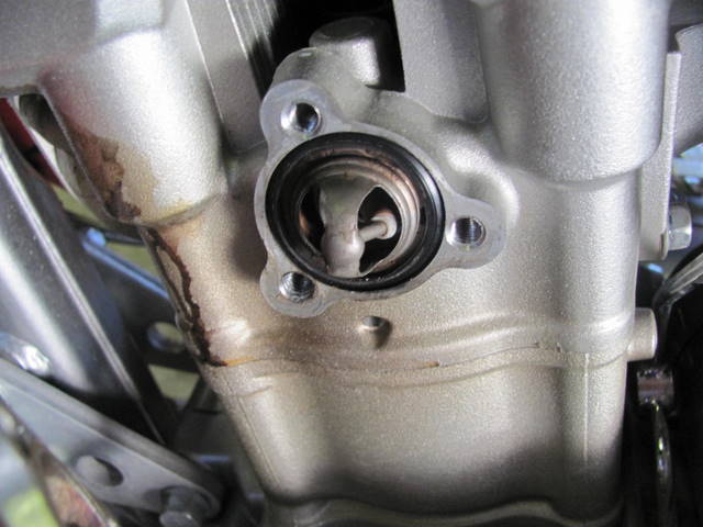

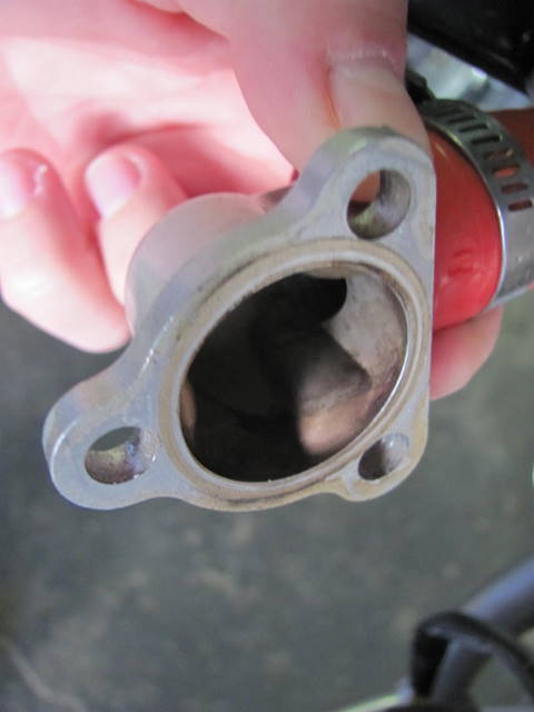

The hissing has stopped since I removed that elbow and lubricated the seal with a little oil. I will have to take a pic of that elbow the next time I get a chance, it really is a very poor design to square the one inside edge that is hidden behid the hose. Seriosuly, go take a look at your bike and I bet it's the same.

Oh, and here's the picture of the piece that I described that looks poorly designed to me. Anyway, anymore opinions and please keep the insults to a minimum as I already know that I am a dumb *** for letting it get this far, but I am blaming the slow leak caused by the crappy part I have pictured. I know that doesn't quite cut it though.
