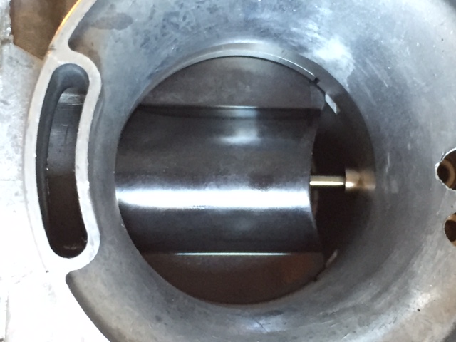

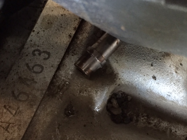

Sounds exactly like the symptoms I had when I re-installed without the needle jet by mistake... just to be clear, as I didn't know when I did it, there is the main jet, that screws into the holder, or emulsion tube (which in turn screws into the carb), but also an additional "needle jet" that goes in first, and is held in by the main jet and holder. So, three components all together, the needle jet having no threads, and being easy to lose.
Below are a few quotes that could be helpful if that WAS the case....
"Well... I had a sneaking su****ion after reading this.....
"There is a brass "collar" sitting above the Emulsion Tube. This is the Needle Jet. It protrudes into the carb bore and it is the first item the needle slides in and out of below the slide. It will likely fall out after you remove the Emulsion Tube. If you leave it out or install it upside down, it's "game over" until you go back in and do it right."...... -Klxster, CVK34 list of issues, problems, fixes, post #14
And sure enough......
After I went ahead and removed the carb, (instead of trying to twist), there it was...I picked up my needle jet, dropped it in and re-assembled.
Now it starts AND runs past 1/4 turn, imagine that!!!! I haven't gotten out for a real ride but I putted around the property with no seat or plastic, and all seems good."
CVK34 list of issues,problems,fixes

I can say for certain that part is not where it should be. Now to find it......
Thanks, I think that got me on my way to a running bike.
