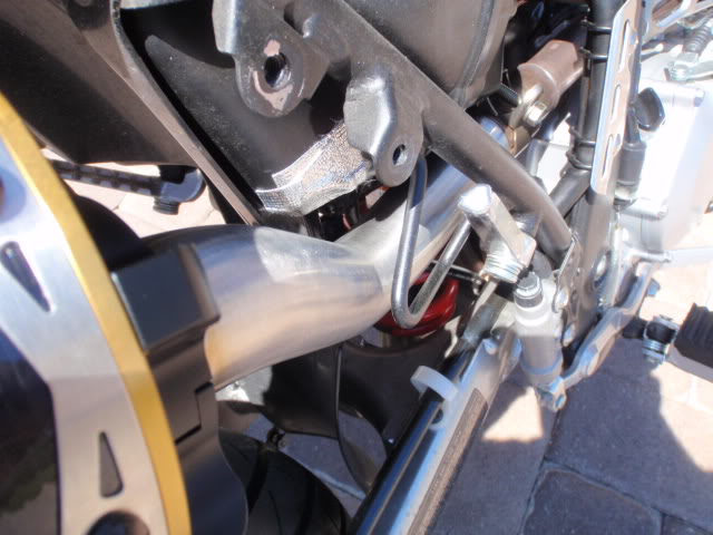

Got the pipe back from TBR.
A couple of things are different:
1. Mid-pipe is definitely bent differently (weld can be seen).
2. X-lite ring is now two pieces.
3. They added a spacer where you connect the canister to the top mounting point.
Installation was night and day compared to the first one. The only challenge, again, was connecting the TBR mid-pipe to the header pipe. Still took some finessing to get it to fit all the way. But from removing the rack and side cover, uninstalling the stock system, adding heat tape and then installing the new TBR and buttoning it all up – it was about an hour in time.
Some pix:
