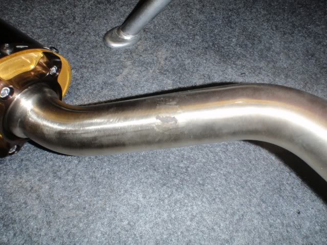

Well I got an email from TBR today. They are asking if the foot guard is bent inward.
I sent them these two pictures along with a couple of others.
I dunno if it is or is not "inward" more than it should be. *shrug*
Anyone have thoughts?

Well I'm sending the S bend tube back to TBR. That's what TBR wants to do. I will say the guy I'm dealing with at TBR has been pretty cool and responsive.
We'll see how much time this process takes. They are in California, I'm in Florida. So 4-5 shipping days both ways and then their time with the tube. So I'm probably looking at a 3-4 weeks.
