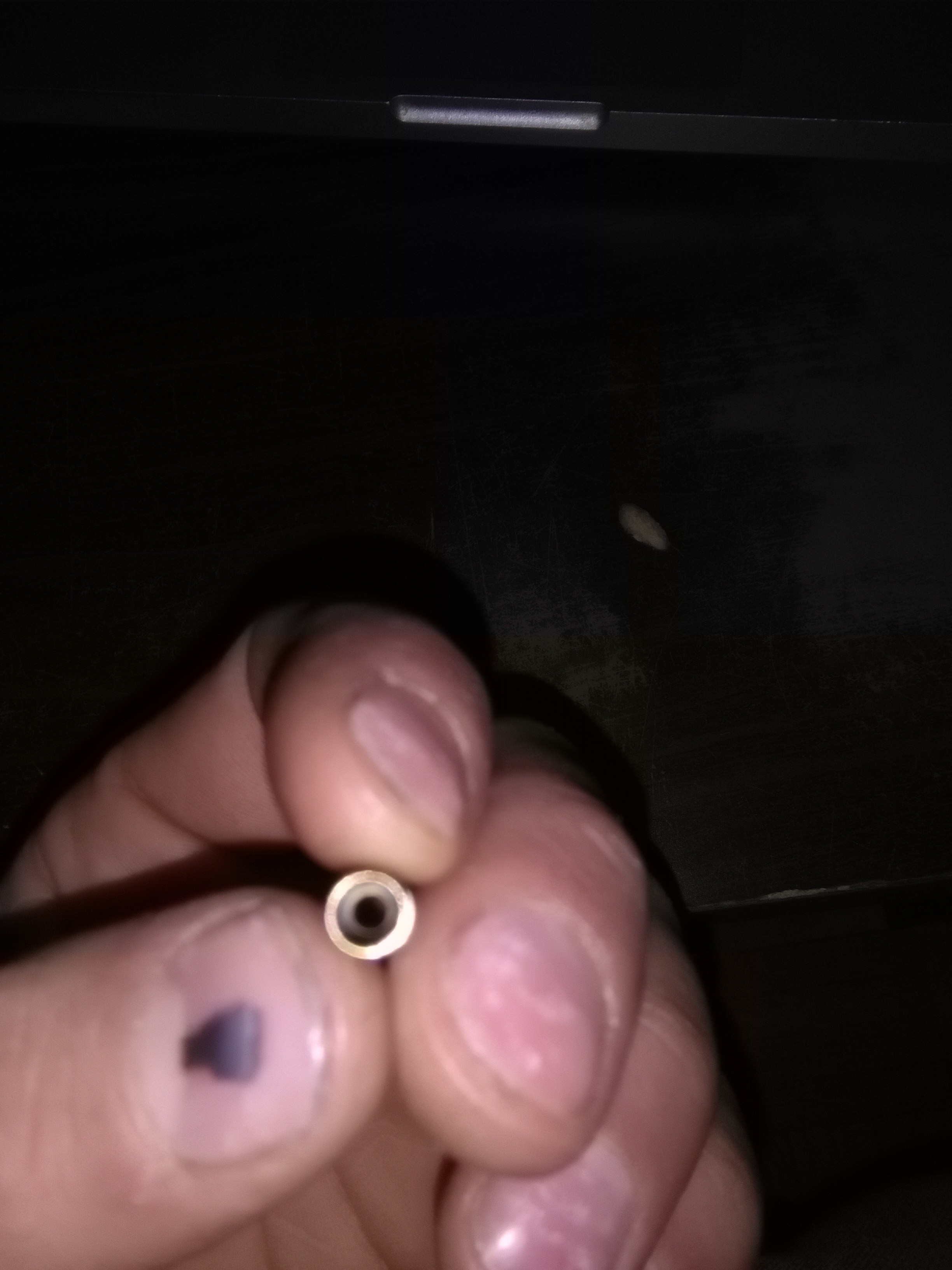

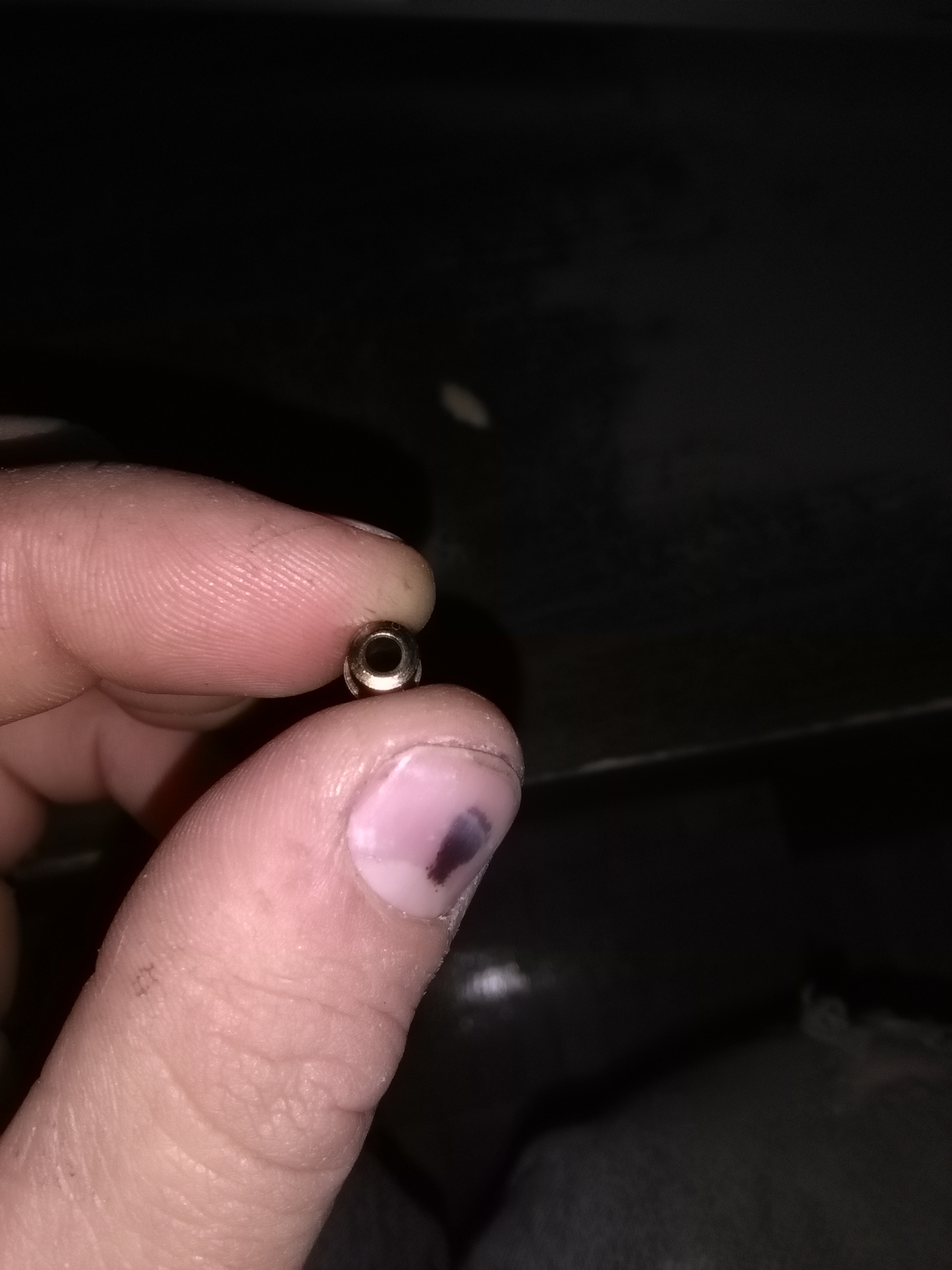

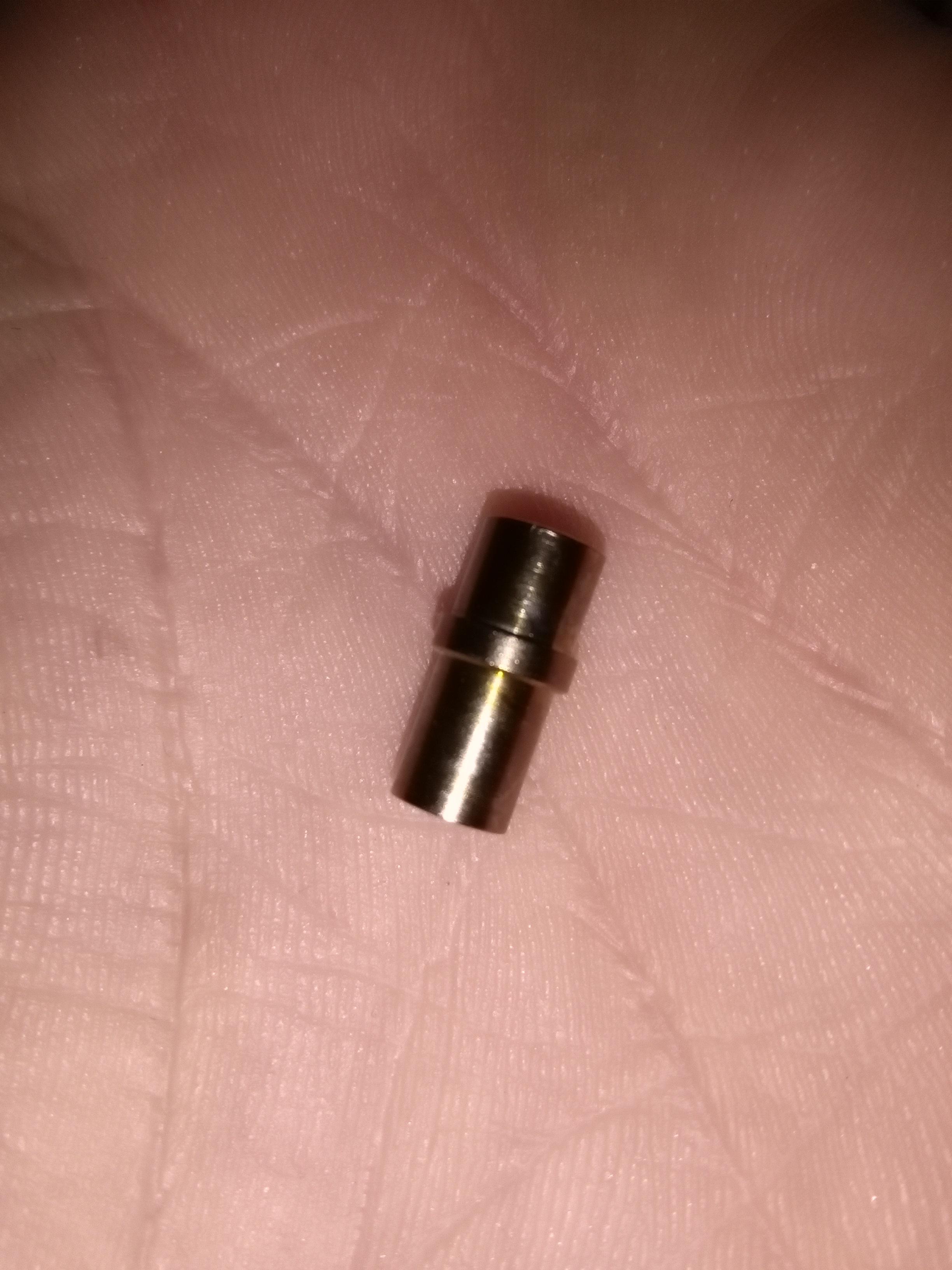

Posts: 53
Also, I have a bit of a dilemma. I didnt properly document where each part was from. Stuck with this bad boy.. I think it comes from the hole where the main jet came out of but not 100%
EDIT= FIGURED THIS ONE OUT . Still need some guidance on the washers and the fuel mixture screw. For now, I am just putting the washers on top of the eclip, between the eclip and the white plastic castle, as per dyno jet instructions..
