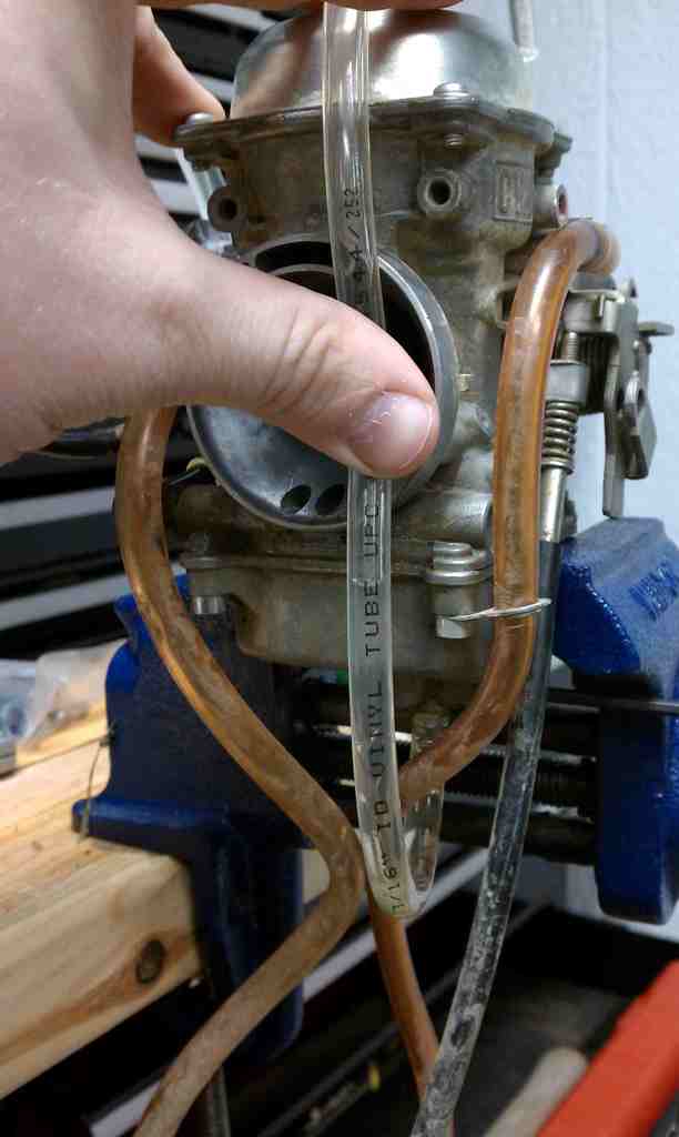

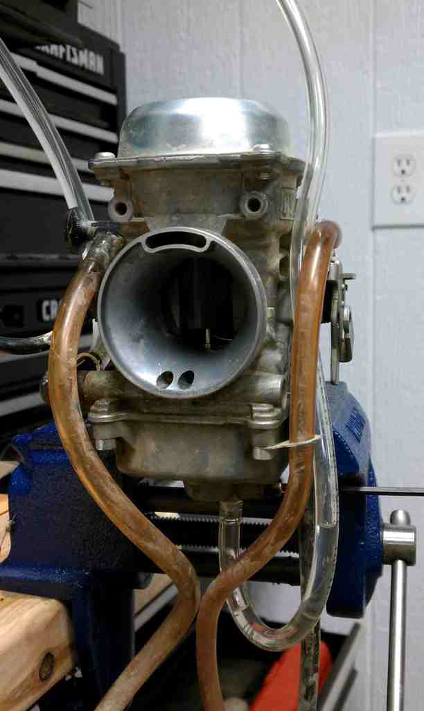

Ok, so here goes my float test. Let me know if I did it right or not. I tried it a couple times and kept getting the results in the 1st picture below. I only was getting fuel in the clear line to the bottom of the float bowl. I knew there was no way that was correct and had to think about what I was doing and what might be wrong. If you look closely at the picture you can see air between drain nipple and the bend in the clear hose. I didn't think that was right and flicked the clear hose with my finger some and shock it back and forth and the fuel rose to the point in the second picture where no air is visibl in the line. If I did this float test correctly then it appears my results show the float is spot on. Correct me if I am wrong or did something wrong here.

Great work, Landon. Yes, that's the way you do it, and it looks like your fuel level is spot on. So unfortunately you still don't have your rich condition figured out, but you know it's not the fuel level, so one issue is eliminated.
