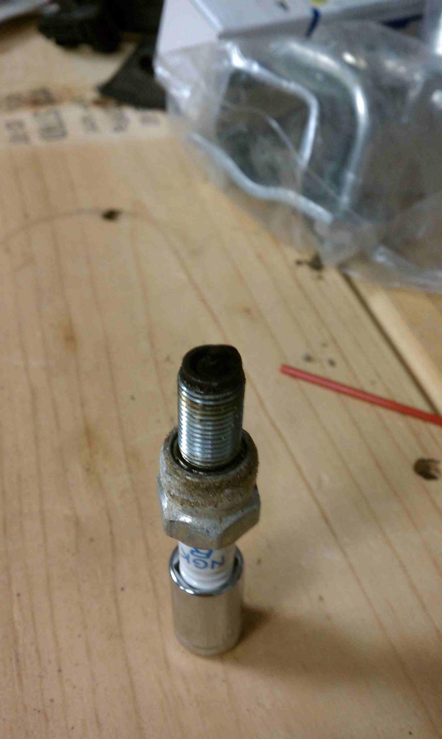

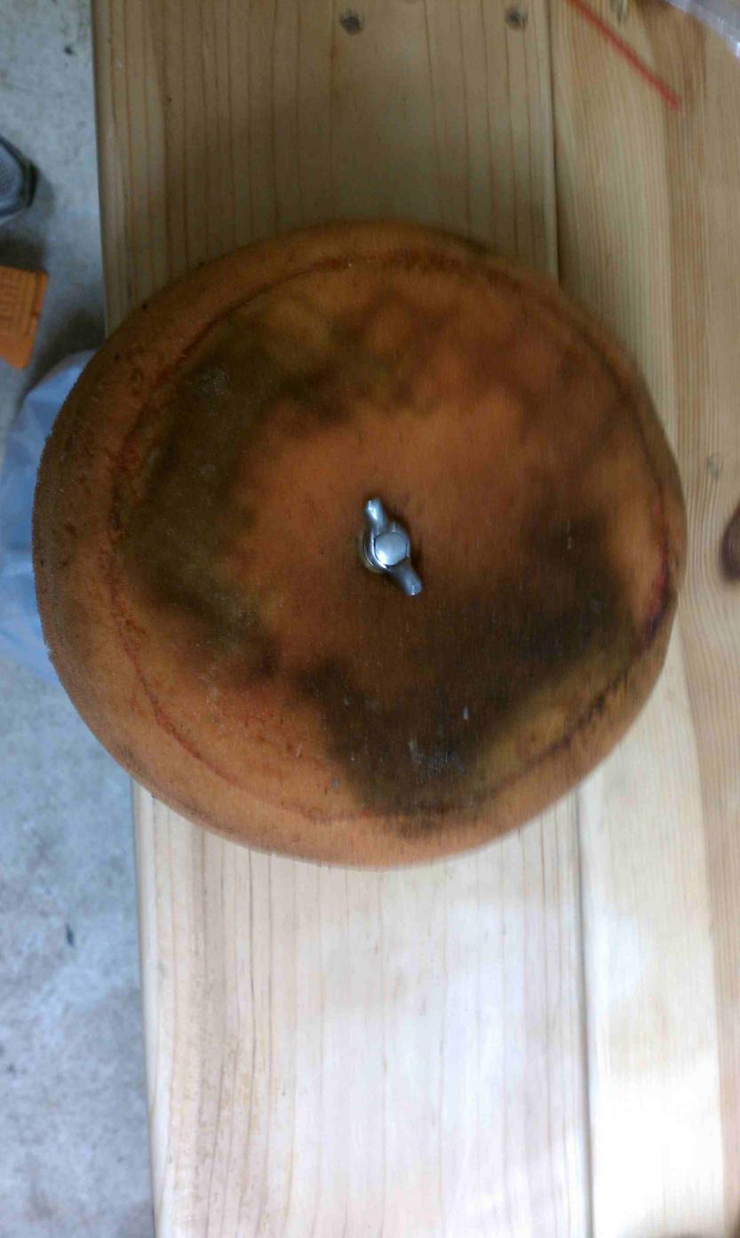

I tore the bike down tonight to check out the air filter and pull the spark plug. The bike is running very rich by looking at the plug. I think I will put the plug back in and put the tank back in place and check the float with the clear tube. I think I may end up pulling the carb and putting it all back to stock other than where the slide was drilled out and I will shim the stock needle with the .032 washer. I am also going to order a uni filter and install it as the one is the bike is pretty dirty and is starting to flake apart. Here are a couple pictues I took.

Wow!...trying to read plugs these days is pretty hard to do with modern fuels and cleaner burning engines...but...I think most folks would say your engine is running horribly rich.
I never had to read one before, and even I nailed what the results of this one told me. LOL.
