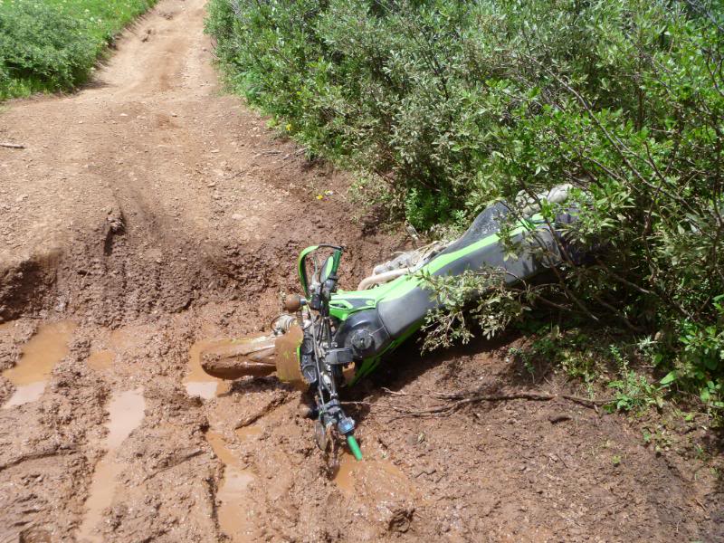

Deej i wanna see a pic like this of your bike....
