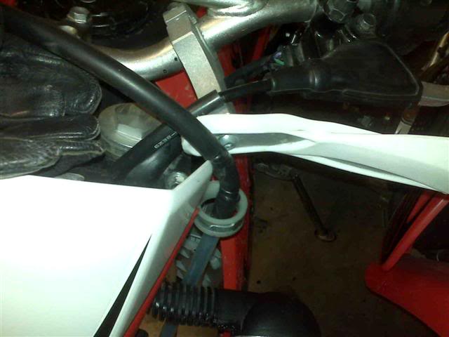

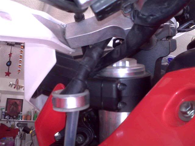

Watch that front brake line. Make sure it can move under full suspension compression. After my first ride in the dirt it took me a few minutes to figure out why my front wheel kept locking up. The PO didn't do a very good job of installing the guards. I see some problems like I had in some of the pics in this thread.

I shaved down one of the mounts, routed the brake line in front of the guard, and with a little fiddling the brake line moves up freely. I also needed to add the prerequisite electrical tape.

I had a similar problem with mine, I had since covered the brake line in electrical tape since it rubs the mount during suspension articulation, and also re-routed the clutch cables to go above the guard.
