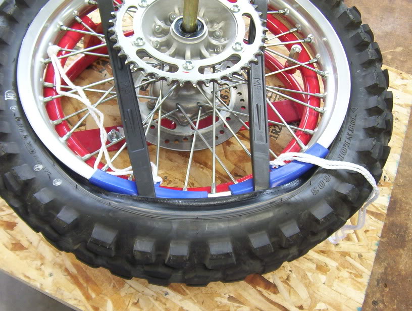

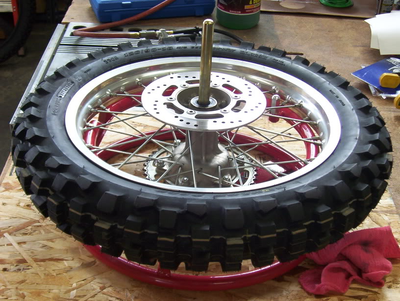

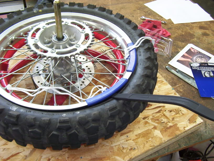

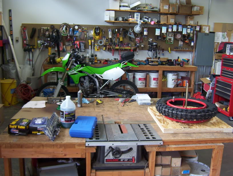

I changed my first and only motorcycle tire last year and it was the 606. From start to finish it was 30 minutes, and that included taking the tire off the bike. You'll get the hang of it. I did buy 2 of the long bars and 2 smaller spoons. Here is a picture of the tire changer that I bought, it works great.

I was actually looking at your thread earlier today and it was then i was hoping i'd get at least 2 of those pry bars. When I change my bro's tires it will be alot faster i'm sure, and I wont mix up the tubes[:@].
Also was curious, using some grease on the bead to get it on easier wont harm nothing would it? I'd hate to find out i made a mistake the hard way if you know what i mean....

I don't know about grease. Many moons ago, when I was a kid, I worked in a Tire Store and we used to use highly diluted soap solution. Mostly water with just enough soap in it to make it slippery for that moment.

Windex is the way to go for the bead. Dries fast for no slipping! I can change both tires in less then 40 min. I use three spoons.
