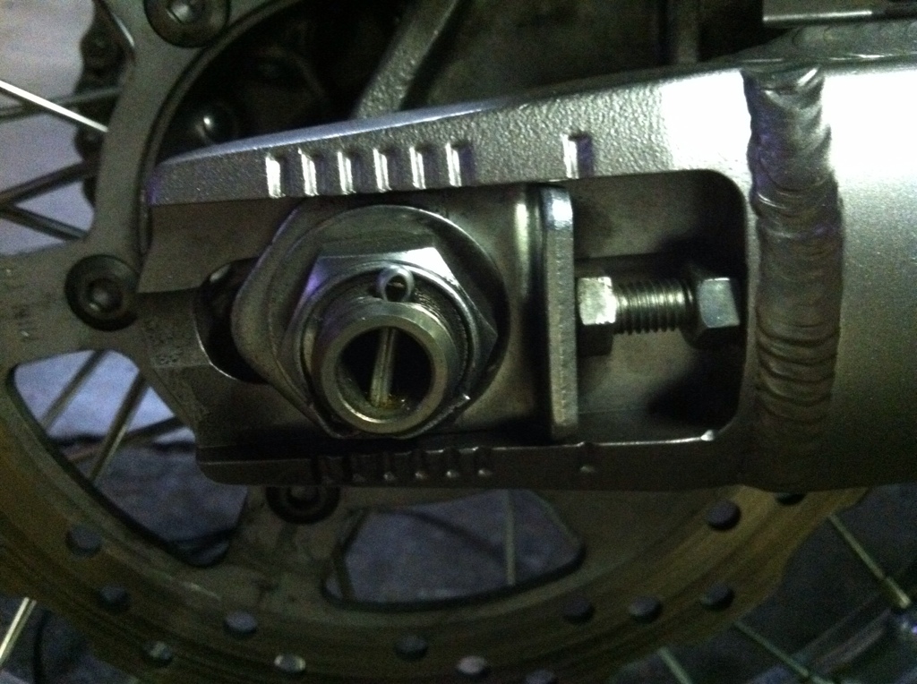

It doesn't take much of an adjustment to fit the 15T. Do you have room to adjust the rear wheel forward right now to get a little slack for the 15T.

this is what I have
