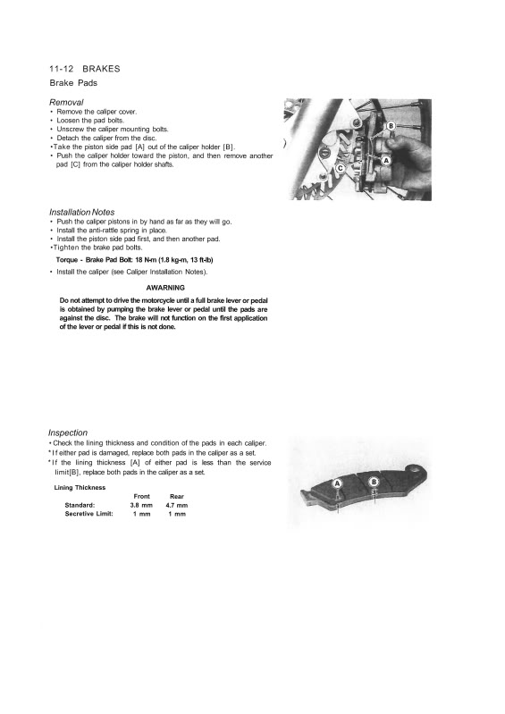

At my last service I was told I would need to replace my front brake pads in about 2000kms time.
I've now done 3000kms since then, so it's probably time to do them...
Is this the sort of job I can do myself? Or do I need to take it to the workshop to do?
It takes like 12 mins to change front brake pads. If you take it to a dealer, you are throwing your money away.
