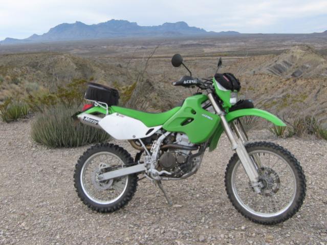

Originally Posted by Ranger Ron
This is how I store mine. This picture was taken in the dead of winter...
Ron
Hey Ron...your pic looks eeriely like mine here in December during storage.
I think we use the same storage facility!
Ron
