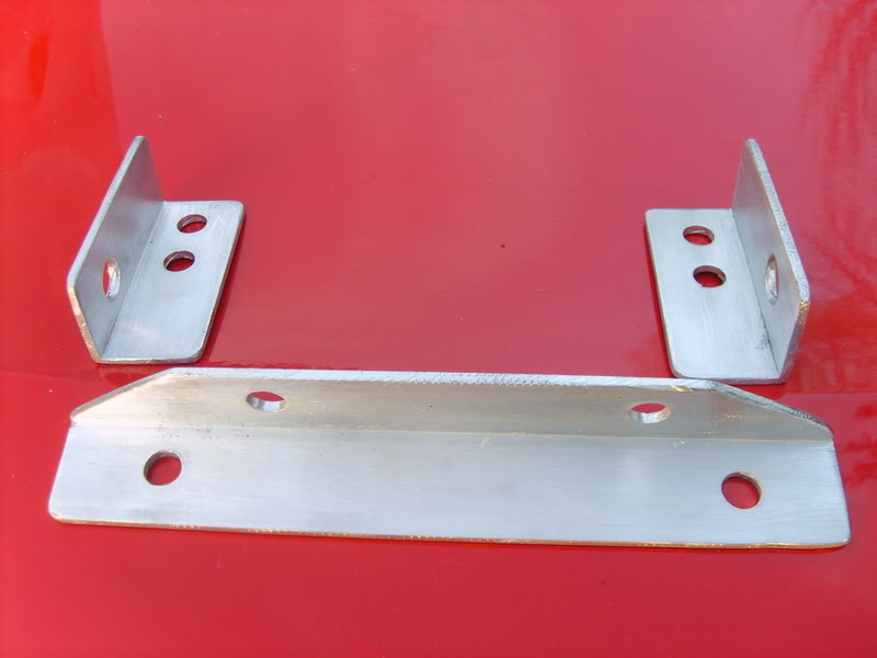

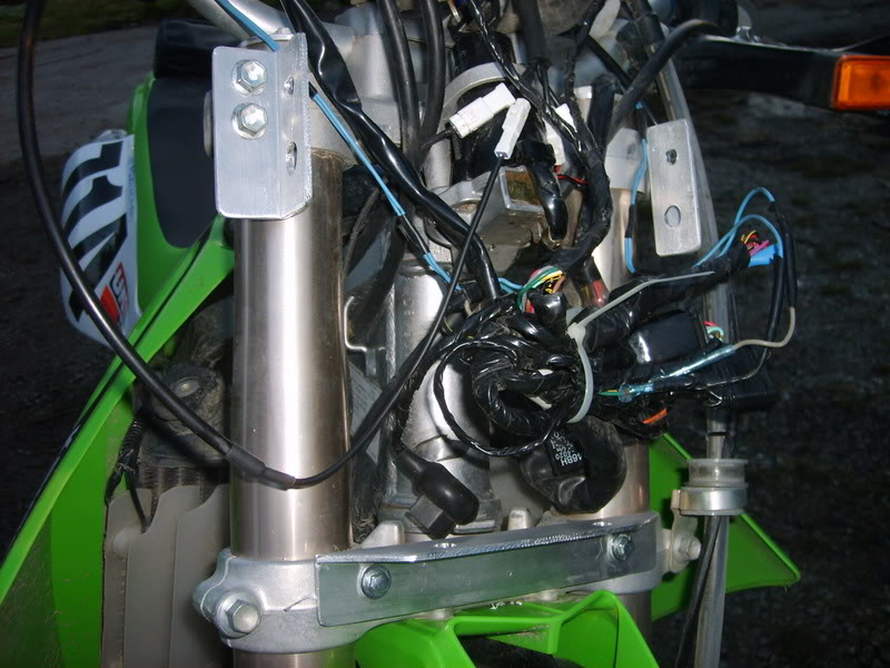

it went on pretty easy i had to make three bracket's out of aluminum
