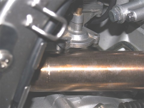

Finally got er done. Not all that difficult to install.
The only problem was the clearance of the a/p allen head screw & header. Easily fixed with a small ball peen hammer.
The OEM Keihin cable mount bracket wouldn't fit because of the frames head stay crossmember. FSW supplied a new cable mount that went on with out hassel and lined it all up. The throttle pull was reduced to less than 90 degrees making it easier to go WFO. The stock throttle was used with only the pull cable. Jerry included an easily accessable fuel mixture screw to dial it all in on the fly.
Jetting was upped from a supplied 50 pilot & 150 main to a 52 & 152, so I had to install the carb twice. Once to test it, second time to rejet. Jerry said he trial fitted the carb on a klx250 he has in his shop, it made it really easy to get it jetted in. Fuel mixture screw is 1.25 - 1.5 turns out. Didn't even have to do the 'Taffey Mod' as it didn't hesitate at all. Awesome.
The improvement in throttle response was immediately noticeable. The motor revved aggressively instead of lagging like the stock carb. Low to mid range performance was improved by at least 25- 30 % over a DJ kitted 34 CVK carb.
Even on a 250cc motor this carb works excellently. FSW supplied extra pilot/main jets (4 pilots, 4 mains) to get it working properly. Nobrakes & Brewster and others aren't lying, this carb makes the bike a different machine.
Time to save aluminum cans for that big bore kit!
