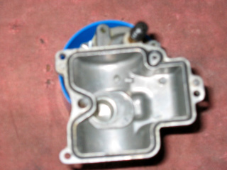

Unfortunately, I didn't take any pictures of that. I may tinker with it this weekend and if I do I will take a pic. I'm not up on posting pics to the net but would be able to send them to an e-mail address. If you have your carb off take a picture of the inside of the fuel bowl and I can point out what needs to be removed.

Trying to learn to post pictures.

I have a 2001 KLX300, so I don't have a starter to give you that comparison. I wish I had the magic button. The pump bowl is about 1" where the stock pump bowl is about 1/4". I didn't take a before measurement, but I probably cut off about half or more of the screw head to give clearance for the header. My picture is blurry, but the hole in the upper right corner, where the gasket makes a circle, is where you have to drill out the brass "check valve". Underneath it will be a tiny ball and a super fine spring.
