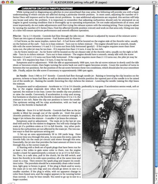

As for the jetting you go for the kawasaki dealer letter mods. WestOz dont you have a copy of the letter from memory?

Thanks heaps for that.
However I took a chance and went to the dealer the bike was sold from, and found out that the bike has already had the de-restriction done(literally flashed up on the screen the last service it was done and listed all the parts etc above). A little dissapointed as i thought i had bought a stock bike and was hoping for a significant improvement, but oh well, saved myself the money and time of doing it.
on the plus side i fitted a 13 tooth front which has made it feel much better, and i can still remove the backfire screen though not sure if its worth it...
