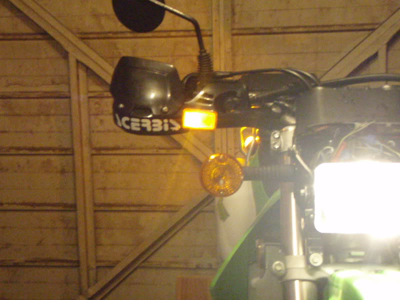

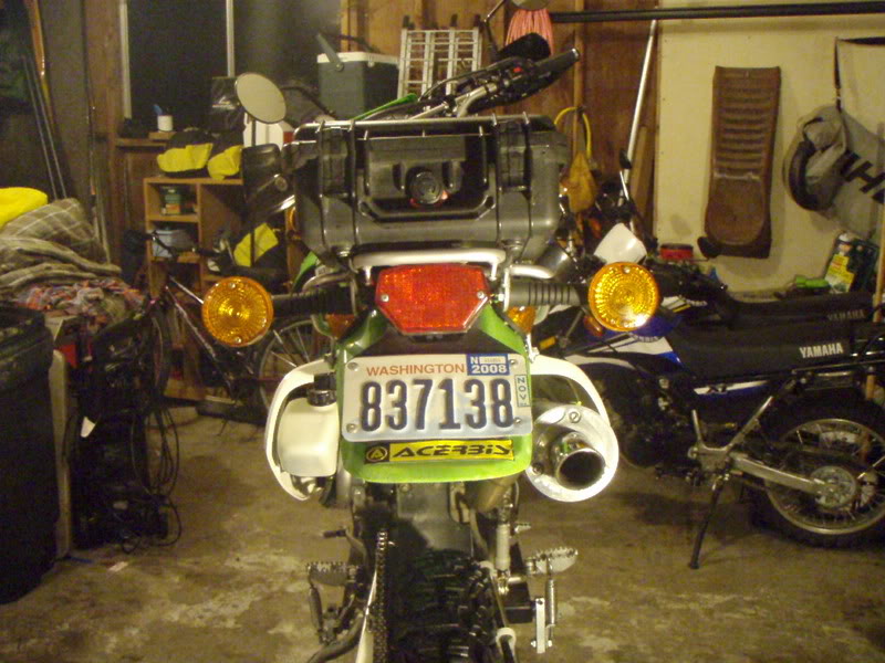

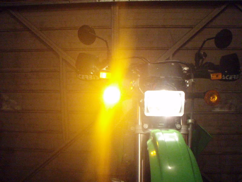

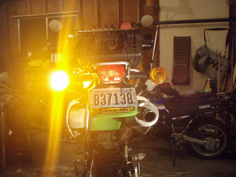

Originally Posted by rickypanecatyl
Deej any chance you have a picture of your blinker set up? I'm all about being seen... and of course keeping the blinkers after serious off road.
You wouldn't by chance know who makes those switches where you can have "flashers" for those foggy nights on the road?
Here are a couple of pictures showing the difference.
blinkers in hand guards

Stock ones
rear
